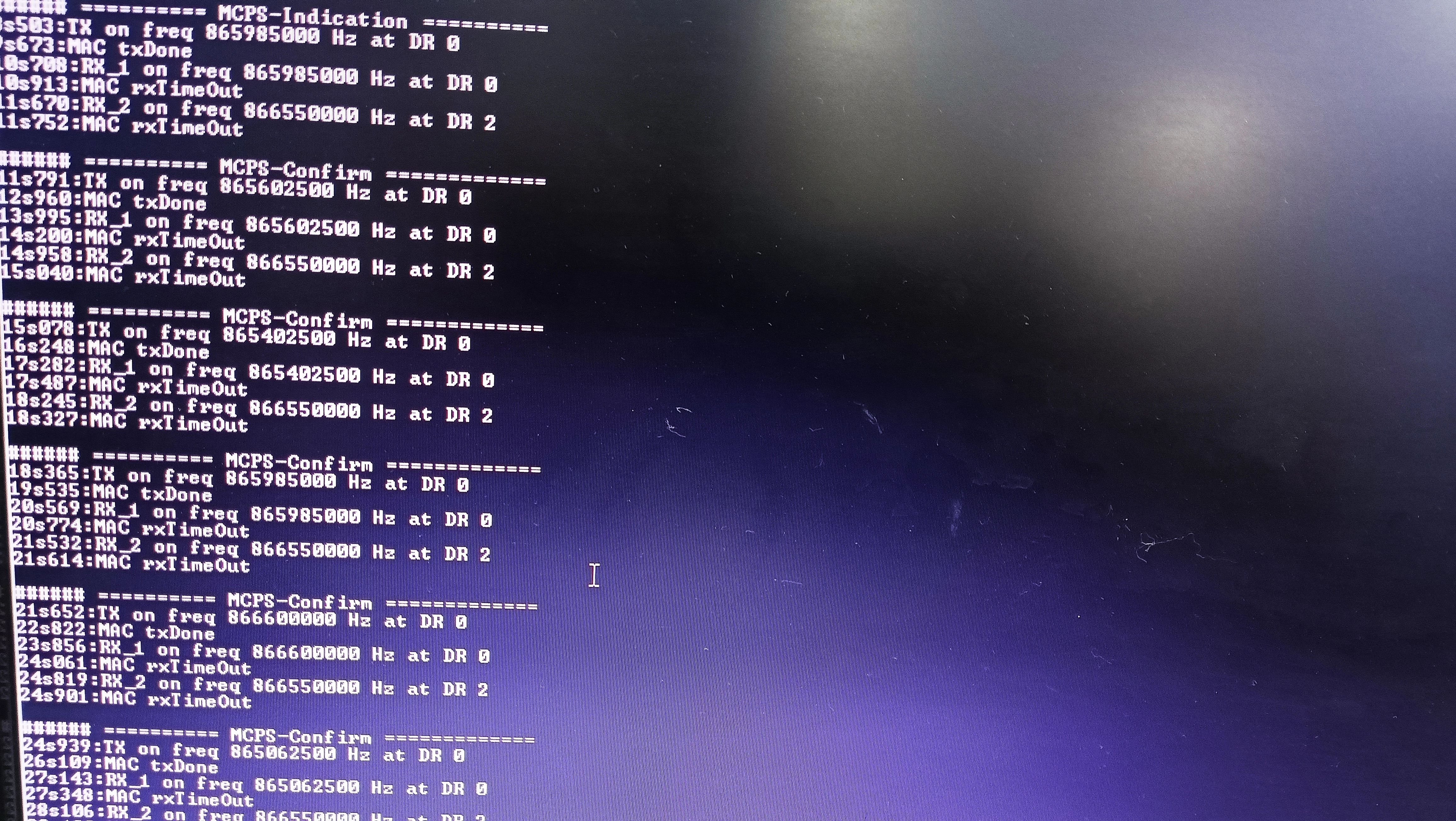

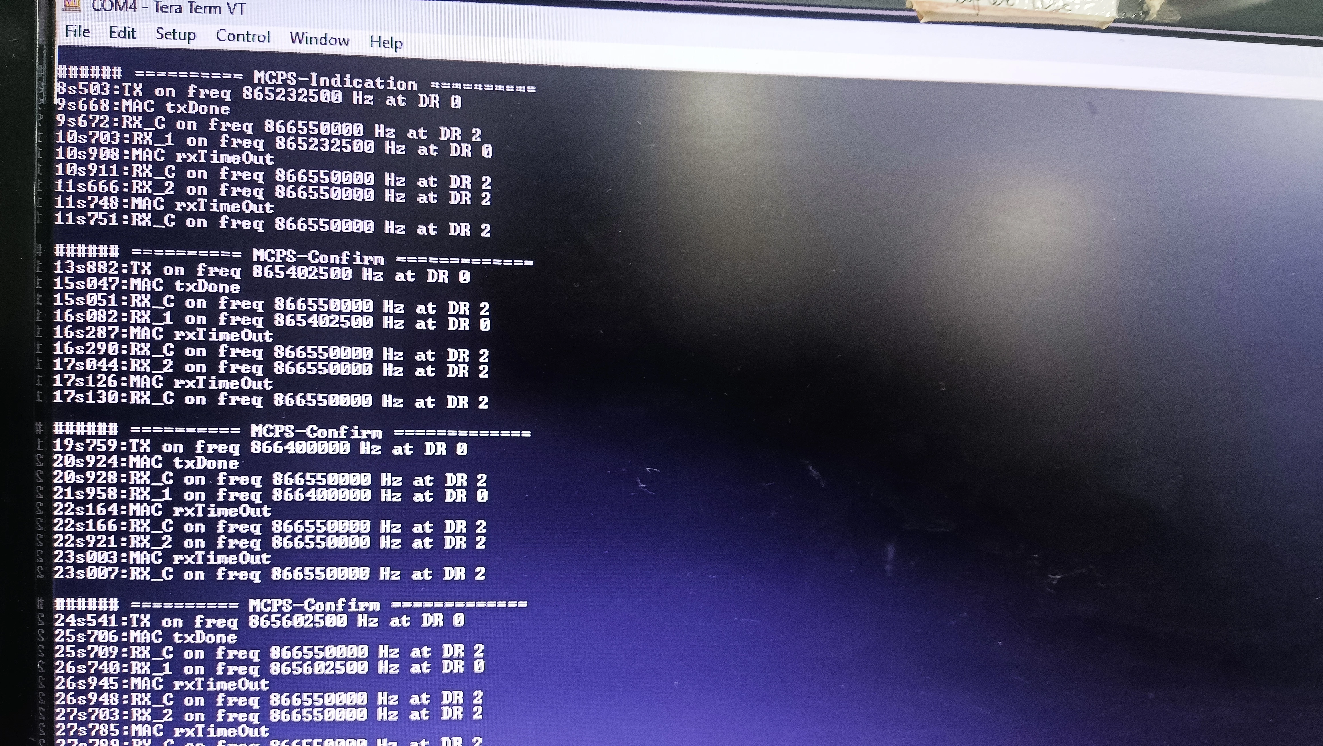

I'm trying to using/operate L072Z LRWAN1 in class c. I'm able to know that node is operating in class c( I'm attaching images below). But i want to disable the receiving window to get faster data rate.
In class A I'm getting 20 frames per minute at SF7. when i try switching to class C number of frames per minute switched to 12 per minute. As the number of frames are reducing the data rate is also decreasing. Hence i want to disable the receiving window to get faster data rate

IMG_Class A.jpg.This image is of terminal In class A.
This is the terminal image of Class C.

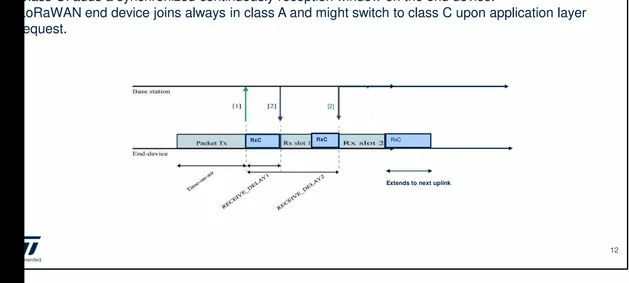

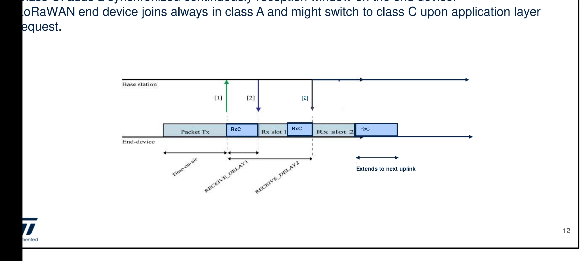

This image show the Tx and Rx sequence in Class C and it matches with terminal image for class C.
Not able to understand the sequence. Why after Tx, RxC,Rx1,RxC,Rx2 then RxC?

The definition of Class C says:
"Class C – Lowest latency, bi-directional end-devices:
In addition to the class A structure of uplink followed by two downlink windows, class C further reduces latency on the downlink by keeping the receiver of the end-device open at all times that the device is not transmitting (half duplex). Based on this, the network server can initiate a downlink transmission at any time on the assumption that the end-device receiver is open, so no latency."
https://lora-alliance.org/about-lorawan/
Disabling the end-device receive is going to break that!

Class A mechanism : Tx->Rx1->Rx2 then next frame. Were as Class C mechanism: Tx->Rxc->Rx1->Rxc->Rx2->Rxc and this is taking more time then class A. hence i want to disable Rxc and Rx receiving windows.

But, again, that breaks the specification for Class C!
