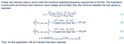

I have found that the formula and the calculated values do not match.
Could you please clarify whether this is due to an issue with the formula or a calculation error?
