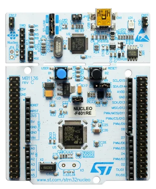

In this article we selected the STM32F401 MCU that can be configured in four different modes: Run mode, Sleep mode, Stop mode and Standby mode. In our test, the NUCLEO-F401RE is configured in the Stop mode.
The purpose of this article is to share tips for power consumption optimization while describing steps to achieve it.
2. Prerequisites
2.1. Hardware
Mini-B USB cable used to power the Nucleo board from a host machine and to load the code into the STM32.
NUCLEO-F401RE.

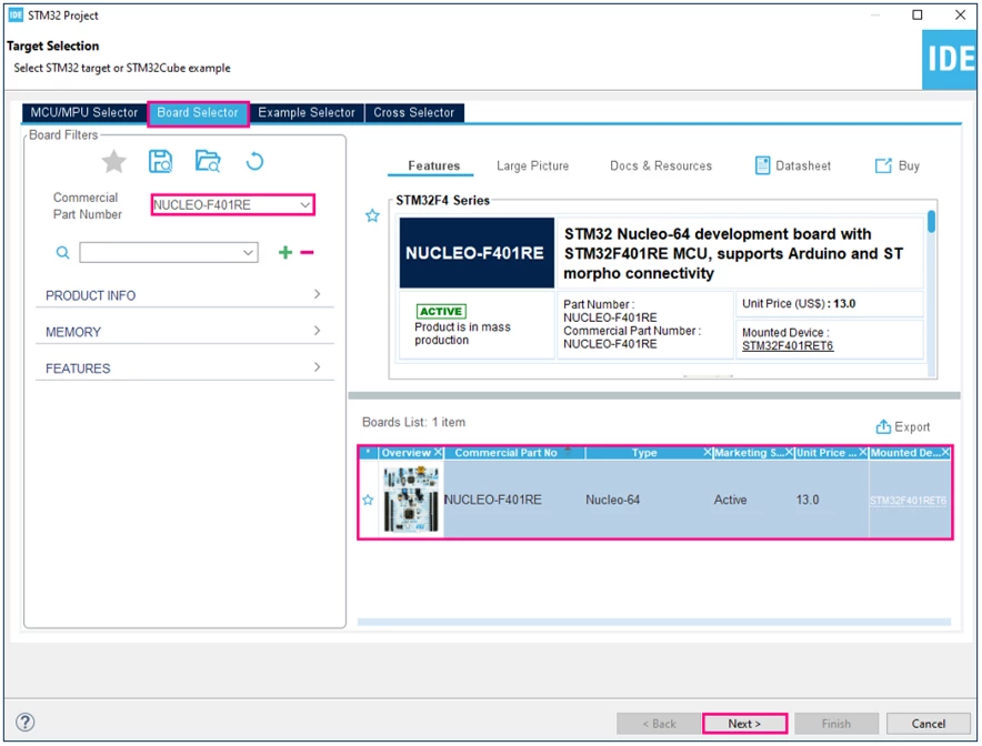

2. Create a new project using the NUCLEO-F401RE board.
Select NUCLEO-F401RE boar using Board Selector:

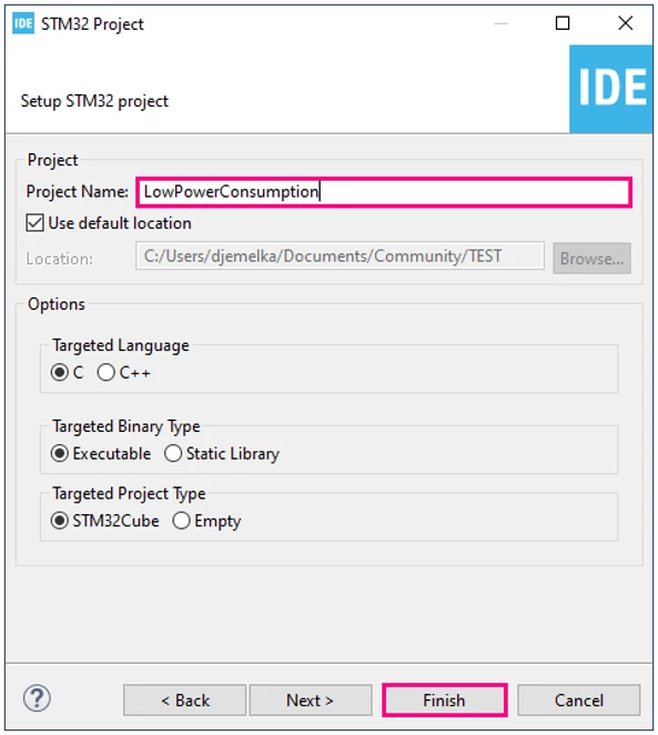

3. Enter a name for the project, for example "LowPowerConsumption".

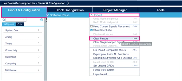

5. Clear pinouts as shown in the below figures or by using "Ctrl+p".

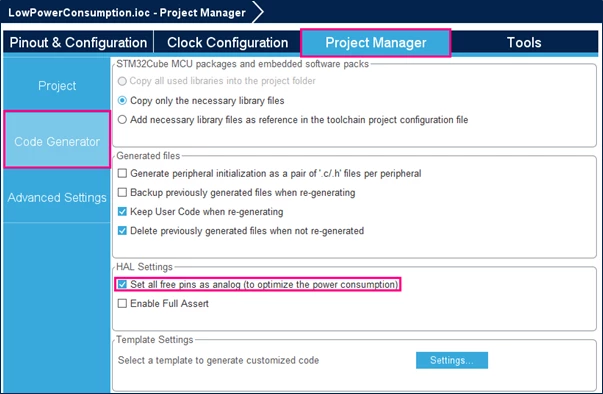

6. Set all free pins as analog (to optimize the power consumption).
In Project Manager tab, select code generator and click on Set all free pins as analog (to optimize the power consumption).
Note that this feature allows the addition of these code lines in the Mx_GPIO_Init function in the main.c file:

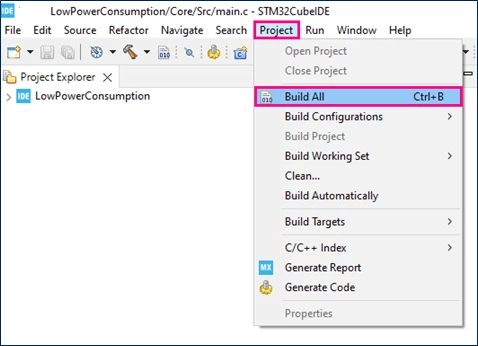

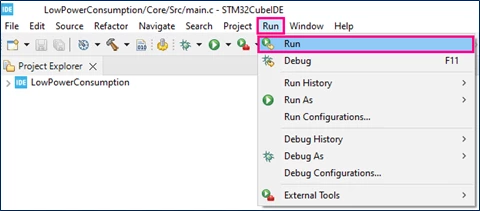

9. Build the project and run the code as shown in the below figures.

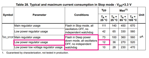

10. To measure the consumption current, just remove jumper 6 and place a multimeter instead of it.
11. In this case the power consumption will be equal to 17µA. This value is similar to the value shared in the datasheet .

  1. When we don’t use the feature of set all free pins as analog (to optimize the power consumption) a supplementary consumption will be added, in our case, 133µA.

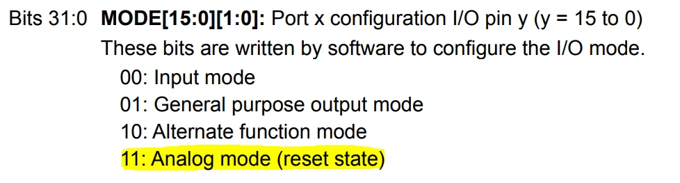

To optimize the power consumption it is recommended to set all free pins as analog.
For the STM32 Ultra Low Power MCUs  like as STM32L4 the reset state of the GPIO port mode is analog mode.
--> since this option applies only to unused pins, what's the rationale for not having it as the default?
I reported this request internally.
The internal ticket 187991 (not accessible by community users) has been opened to confirm and fix the issue.
Thank you for your sharing and for your contribution in STCommunity :).
Kaouthar
