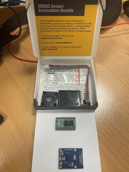

The evaluation kit is made up of an electronic and a mechanical part.
  • The electronic part includes: the evaluation board, a DIL24 adapter, and a flex cable to connect the evaluation board to the DIL24.
  • The mechanical part consists of an ad hoc plastic holder (with screws and nuts) and a particular lens coming from the Fresnel Factory.
In the first part of the article, we are going to use the electronic part only. The mechanical part comes later.

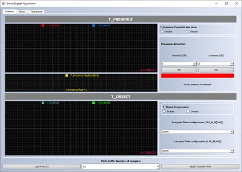

In the Smart digital algorithms tool, you can configure some parameters for the internal algorithms: threshold and hysteresis for presence detection, motion detection, and T_ambient shock detection.
Smart Digital Algorithms toolSmart Digital Algorithms tool
In the same window also the low-pass filter settings are available, those filters act directly on the three detection algorithms.
Find out more on the embedded presence, motion, and ambient temperature shock detection in the datasheet and the application note documents of the infrared sensor.
These algorithms are embedded in the device, so the current consumption is low.

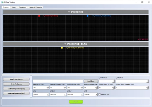

Before that, let us see another tool available in Unico-GUI for the infrared sensor.
It is the Offline tuning tool, which allows to find an optimal configuration for the different parameters based on some data logs previously acquired.
Offline tuning toolOffline tuning tool
Presence, motion, and ambient shock detection algorithms have been ported to software models and integrated in this tool for offline analysis and parameters tuning.
The board connection in this case is not mandatory.
The user can upload a recorded log for parameter tuning by loading a labeled csv or tab-spaced log file (including a header row with labels).
Once the T_Object ID or/and T_Ambient ID header labels are selected, the START button for log processing is enabled.
By clicking on the START button, the presence, the motion, and the T_Ambient shock detection algorithms are executed, using selected parameters values.
The register configuration (.ucf) file can be saved / loaded using the load / save configuration (.ucf) buttons.
Processing results can be exported into a text file by using the "save data (.txt)" button.
If the board is connected, the displayed parameter values on the GUI can be read from the device or stored in it by using the read / write configuration buttons.
The advantage of using this tool is to use just one single logging instance of your application use case. By iterating the fine-tuning of the algorithm, you can find the best parameters for your application.

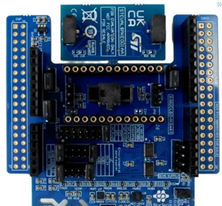

Let us talk about the STM32 Open Development Environment, which includes a dedicated library for the infrared sensor. We are going to use the new X-NUCLEO-IKS4A1 expansion board, mounting it on top of a NUCLEO-F401RE board.
In this case, we are not using the DIL24 adapter, as the flat cable can be directly connected to the evaluation board. Then, the X-NUCLEO-IKS4A1 expansion board can be plugged to the Nucleo board (in this case it is the F401RE). Finally, the Nucleo board can be connected to the PC through USB.
X-NUCLEO-IKS4A1X-NUCLEO-IKS4A1

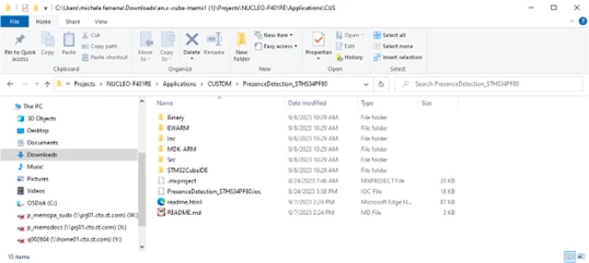

To use the infrared sensor with the Nucleo board we need a dedicated firmware, which is included in the X-CUBE-MEMS1 expansion pack.

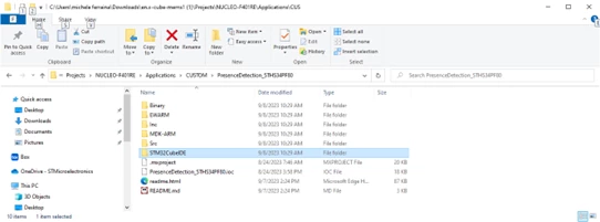

After downloading this package from the ST website, you can navigate to the /Projects/ folder. Here you can find the project for the different Nucleo boards supported. We select /Nucleo F401../
X-CUBE-MEMS1 expansion pack: folder /Nucleo F401../X-CUBE-MEMS1 expansion pack: folder /Nucleo F401../
Then /Applications/CUSTOM/PresenceDetection…. Here you can find the source code of the firmware, which you can open by different environments including IAR, Kiel and STM32CubeIDE.
X-CUBE-MEMS1: the source code of the firmware is available for different environments including IAR, Kiel and STM32CubeIDEX-CUBE-MEMS1: the source code of the firmware is available for different environments including IAR, Kiel and STM32CubeIDE

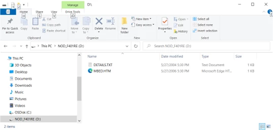

There is also a folder /Binary/ containing the .bin file of the prebuilt firmware, which can be directly loaded to the Nucleo board.
The binary .bin file of the prebuilt firmware is availableThe binary .bin file of the prebuilt firmware is available
To use the binary, you can drag and drop the prebuilt .bin file from the “Binary” folder to your Nucleo board folder. You can find more information about the loaded application in the user manual UM3169, which is available on our website.

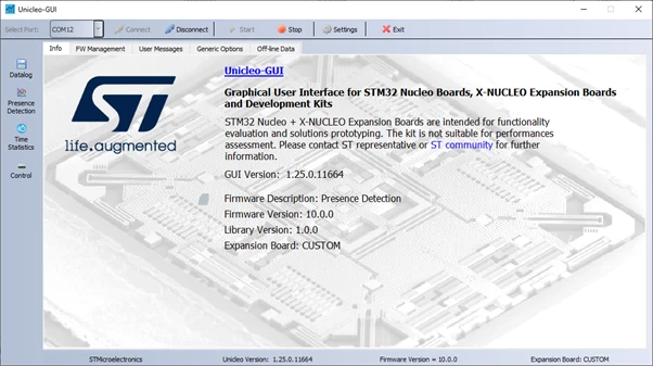

4. Test custom firmware with Unicleo-GUI
Unicleo-GUIUnicleo-GUI
The application, which we have loaded through the firmware binary in the X-CUBE-MEMS1 expansion pack, shows how to use the presence detection library. The goal is to obtain object presence and motion data, using an infrared sensor only. The data is sent from the Nucleo board using UART to a connected PC.
On the PC we can use the software Unicleo-GUI, which is a graphical user interface for the X-CUBE software expansions and STM32 Nucleo expansion boards.
After a connection has been established:
  • The user can view raw ambient and object temperature [LSB] data from the infrared temperature sensor.
  • The user can view compensated object temperature [LSB] and its change rate [LSB] together with Object presence and motion detection flags.
  • The user can store the data in a .csv file.
