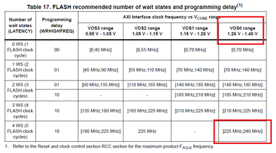

There are error displays (red markings) in the following cases:
STM32Cube_FW_H7_V1.12.1
STM32H743VIT6
SYSCLK <= 240MHz (actually, for any frequencies from 225.5 to 240MHz)
HPRE Prescaller = 1
There are no errors in cases where HPRE >= 2, for example, for SYSCLK = 480MHz.
Please see the screenshot
STTwo-32

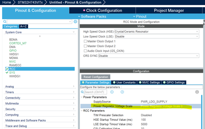

This error means you the clock after HPRe prescaler should be <=225MHz. to be able to set this clock to the max value, you have to go to RCC>Power Regulator Voltage Scale and set it to Power Regulator Voltage Scale 0:

If you need to set the same frequency value for System clock and AXI-AHB, you need to take care of the voltage scale. Please refer to the RM0433 / Table 17. FLASH recommended number of wait states and programming delay
In your case you need to set VOS to 0. The issue will disappear.

The default value for the Power Regulator Voltage Scale is 2 in this case, and it needs to be changed manually.
Thank a lot STTwo-32
