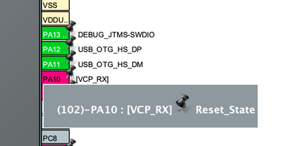

I generate the code anyways, and when I navigate to the pinout & configuration window, I see that CRS SYNC has a conflict with PA10.

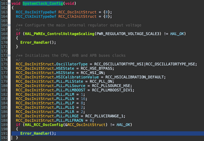

When running the auto generated main.c program, an error is thrown on line 170 in SystemClock_Config() in main.c.

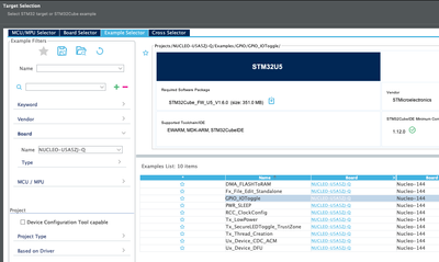

I wound up using an "example" shown here. This generated code worked out of the box for me. Good luck!

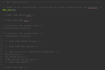

Thanks bdeming155, I fixed the issue by commenting some init after the HAL_Init() because I checked it was redundant: in this way it worked.
