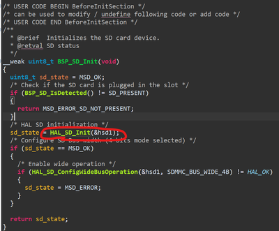

‎2025-01-11 2:50 PM
It's done in the BSP initialization here:
‎2025-01-11 2:43 PM
Just write sd init here :
/* USER CODE BEGIN SDMMC1_Init 2 */
if (HAL_SD_Init(&hsd1) != HAL_OK)
Error_Handler();
/* USER CODE END SDMMC1_Init 2 */
...if you want init at program start. (Is same on older versions of IDE, so no bug, i suppose.)
‎2025-01-11 2:50 PM
‎2025-01-15 12:36 PM
Yes, I did, but STM32CubeMX should have generated it on the right place.
