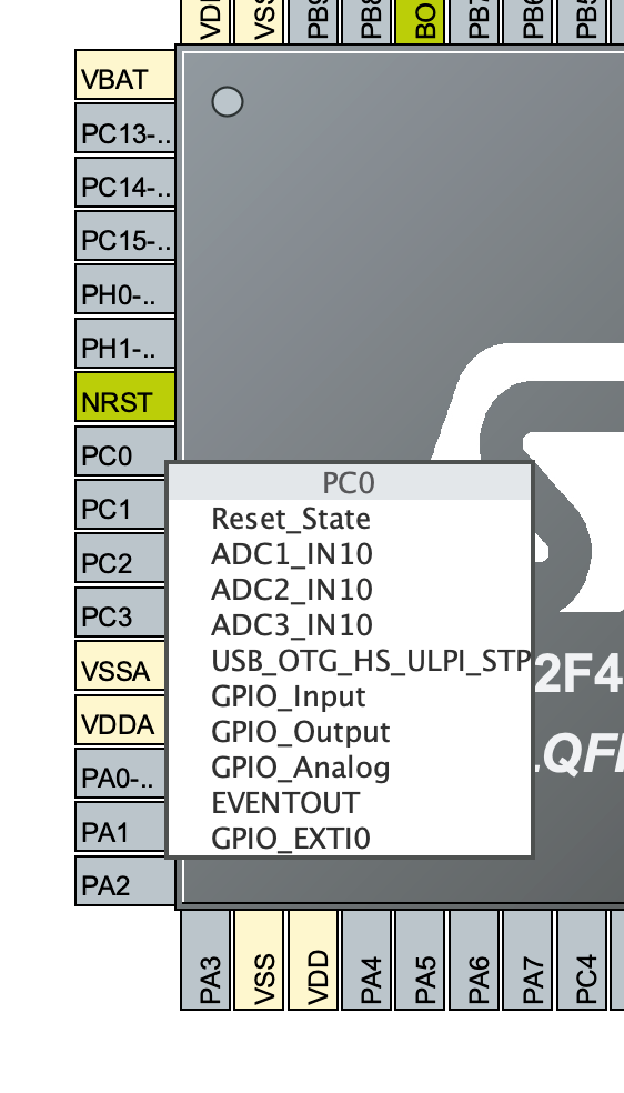

Studying the schematic, I can see the neopixel is connected via pin PC0. This is where I'm getting a bit lost - I *think* what I need to do is configure PWM using some timer settings somewhere (?), then connect this pin PC0 to that timer/pwm generator. But it's not clear to me how to do this in the cubeMX/visual configuration side of things.
I can see, when I click on some of the pins in the Pinout & Configuration settings, that some have timer options listed among the available settings. But PC0 does not:
So it's not quite clear to me how to proceed (and, again, I am VERY new to this, so just understanding the relationship between the timers and pins and all the configuration settings has put me in a bit of an overwhelmed state). How was it that this neopixel might have worked initially?

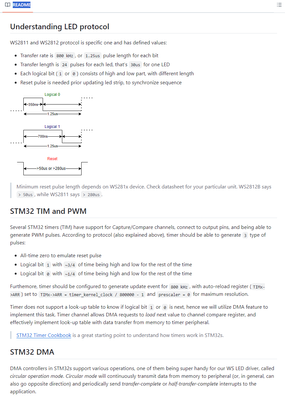

For this link: https://github.com/MaJerle/stm32-ws2811-ws2812-ws2812b-ws281x-tim-pwm-dma-timer
Read the readme file:
As you are new in the STM32 world, not easy to explain you all the mechanism. You need to start somewhere. I think you need to start some STM32 courses to understand the environment and tools and how STM32 are working.
I suggest you so start with this wiki: https://wiki.st.com/stm32mcu/wiki/Category:Getting_started_with_STM32_:_STM32_step_by_step
See also this thread.
https://community.st.com/t5/stm32-mcus-products/for-better-learning-stm32-programming-and-debugging/m-p/721123
Hope it helps.
To check, your first entry point is always the documentation.
Regarding the pinout, you need to refer to the datasheet DS8626 / Table 7. STM32F40xxx pin and ball definitions:
As you can see PC0 doesn't have any TIM alternate function. So I think the Neopixel in your board is managed by GPIO and (maybe) driven by a timer.
As your LEDs have the part number WS2812B, I suggest you to refer to these links:
https://community.st.com/t5/power-management/controlling-ws2812b-led-strip-with-stm32/td-p/73747
https://controllerstech.com/interface-ws2812-with-stm32/
Hope it helps.

@sb_st wrote:
Much of the examples I found online presupposed I am using a Nucleo board, or at least have some amount of control as to which pin I connect a neopixel
NUCLEO or not, it's an STM32 MCU used. So need to adapt the code from any platform (Nucleo or something else) to you specific board, for example need to use PC0 in your case.  But in your case you are using stm32f405 on which PC0 is not having any Timer output function. So may be you need to control the timing using a Timer while setting the GPIO.
Hope it helps.
PS: Be polite in your reply. Otherwise, it will be reported as inappropriate and you will be permanently blacklisted from my help/support.
