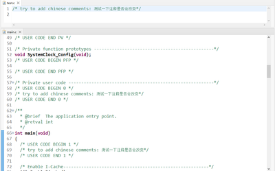

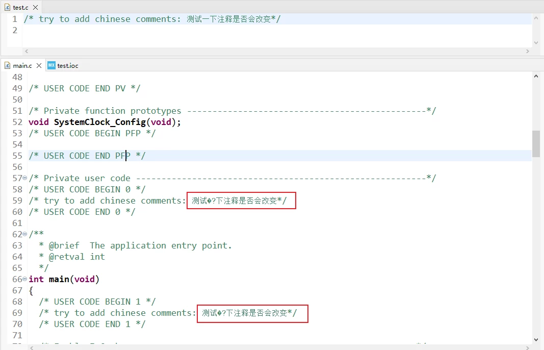

there is a strange phenomenon. I write some chinese comments in main.c and other files. when I use cubeMX to regenerate the code. the comments in main.c are partly changed and can't be display correctly. but the comments in the file that don't be regenerated by cubeMX are correct and don't be changed.
then I regenreate the codes by stm32cubeMX.

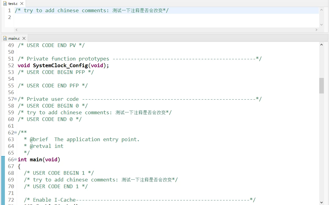

the mistake happend. I use the defualt configuration. but when I set encoding with GBK. the problem disappears.

Hello @xixi ,
Thank you for bringing this issue to our attention.
I confirm the issue with STM32CubeMX 6.11.1 and I reported internally.
Internal ticket number: 184619 (This is an internal tracking number and is not accessible or usable by customers).
Thank you.
