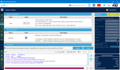

At this point I tried to upload the basic firmware but for my surprise the CubeIDE is telling me that is not possible to upload the code.
Please find below some screenshots of what the software is showing me and also all the messages given to me, not only by CubeIDE, also by STM32CubeProgrammer.

12:39:03 : UPLOADING OPTION BYTES DATA ...
12:39:03 : Bank : 0x00
12:39:03 : Address : 0x40023c14
12:39:03 : Size : 8 Bytes
12:39:03 : UPLOADING ...
12:39:03 : Size : 1024 Bytes
12:39:03 : Address : 0x8000000
12:39:03 : Read progress:
12:39:04 : Error: Data read failed
At this point I tried to find some help from STM32 Developers group on Facebook at first time, but without any luck.
What I search over Internet is that maybe the problem comes from RDP bytes and when I checked it, the value found by STM32CubeProgrammer is 0xFF, none of the possible values (0xAA, 0xBB or 0xCC).
I tried to change the value to one of the possible values and press the "Apply" button, but without success again. Below you will be able to find some screenshots related to it.

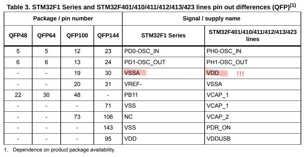

For this you need to check AN4904 "Migration of microcontroller applications from STM32F1 Series
to STM32F4 Access lines"
The pinout difference, with LQFP64, is the VCAP pin on STM32F4 which was PB11 on STM32F1.

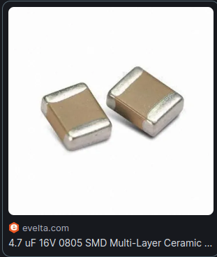

VCAP pin needs to be connected to GND over a 4.7uF ceramic capacitor:
Refer to the AN4488 "Getting started with STM32F4xxxx MCU hardware development"

First of all let me thank you for your reply. I soldered an electrolitic capacitor between VCAP pin and GND (of course positive side to VCAP pin and negative side to GND). But this didn't worked and I'm still unable to flash the MCU.

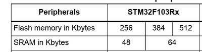

There are other variants of the STM32F103 that have much more flash / RAM.
As said previously you need to check at first your HW, especially with the two application notes I provided.
Wrong ! You have to use a cer.cap , short (wire) connection vcap--gnd .
This is the core supply, a elko almost useless here.

Nothing in AN4904 suggests that STM32F412RET6 is a drop-in replacement for STM32F103R8T7. I think you misunderstood what CubeIDE means by "compatible". It doesn't look like it's "compatible" at the pin level. i.e. you can't just solder a chip from another family in place.
ST may have kept "most" pins compatible between packages across families. But you only need one pin wrong to have your design fail:
Find a 100% pin compatible replacement that meets your needs, or re-spin the board (the necessary changes to layout should be minimal, so ST claims).

You complete miss with hw replacement, start with place back 103R8 and optimize your code to level 3.
Next switch HAL to LL for RCC, GPIO ...
How much memory you require? F103 exist with many flash sizes

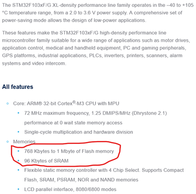

STM32F103R8 - Mainstream Performance line, Arm Cortex-M3 MCU with 64 Kbytes of Flash memory, 72 MHz CPU, motor control, USB and CAN - STMicroelectronics
STM32F103RD - Mainstream Performance line, Arm Cortex-M3 MCU with 384 Kbytes of Flash memory, 72 MHz CPU, motor control, USB and CAN - STMicroelectronics
And for replace MCU you start new schematics and PCB.
btw F103 ....up to 512K flash :
F103RG has up to 1 MB flash, 96 KB SRAM.
