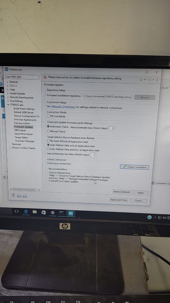

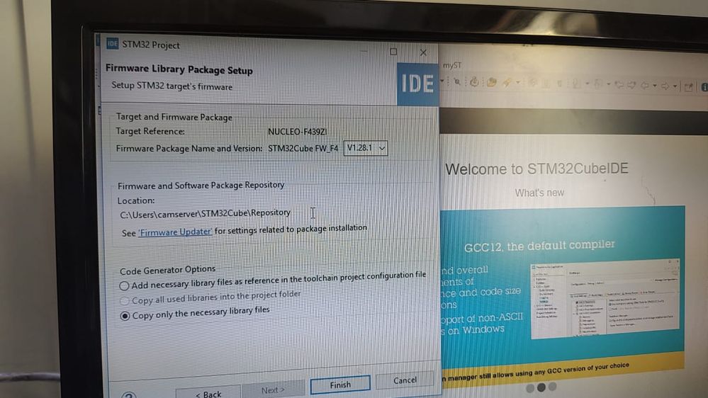

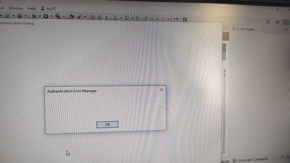

I have installed STM32Cubide v 1.16.1 on both linux as well as on windows machine. After installation i tried to create project creation. I select board which is (Nucleo F439ZI) then clicking on next finish --> it ask my for myST login --> Code generation pop up window came up and in tips asked me to do Project --> genrate code (Necessary firmware packages is misssing) once i click on ok project created with only .ioc file. Other file is missing.

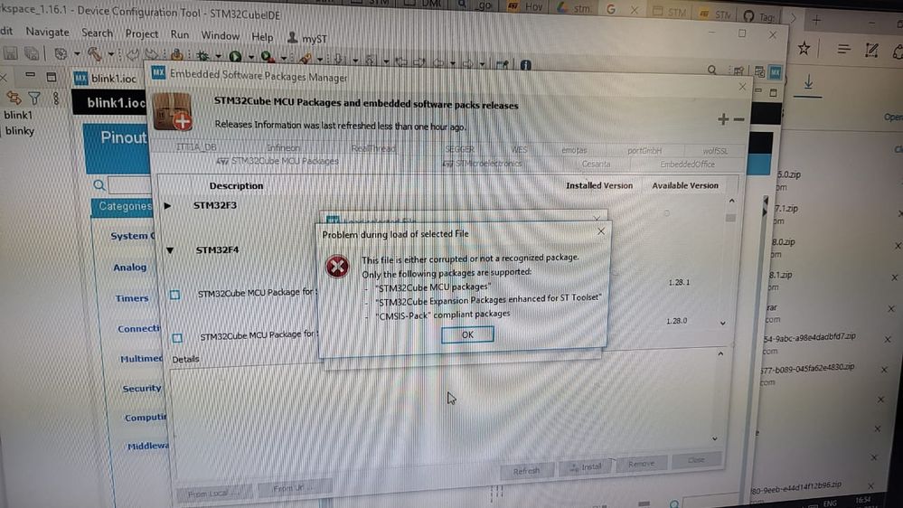

--> from help i tried Check for target selector then manage embedded software packages --> my STlogin again came up and Connection time out message even if my internet is working fine.

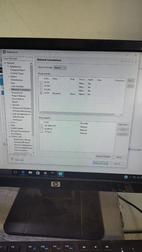

--> is there any proxy related issse?
--> uplaoding snapshot of mine network connection setting.

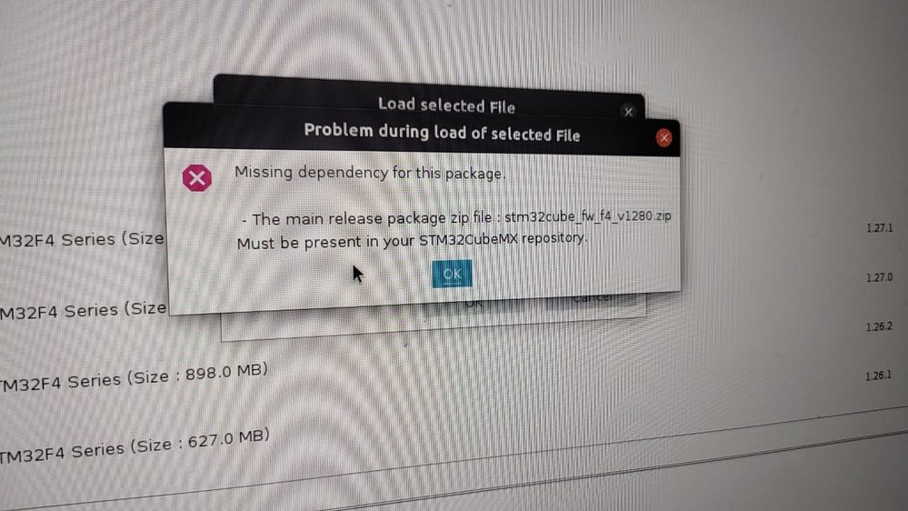

--> also tired offline downloaded packages and upload form local still getting errror. (missing dependecy of packges)
--> I tried with so many settings kindly help me to solve this issue.offiline installation from local driveoffiline installation from local drivenetwork connection settingnetwork connection setting4.jpegmyST login errormyST login error2.jpegImage 2024-11-09 at 11.02.03 AM.jpeg

Hi @bhaveshk ,
Could you please double check that the required steps as described in How to set the network connection parameters for STM32CubeIDE and STM32CubeMX are followed properly?
