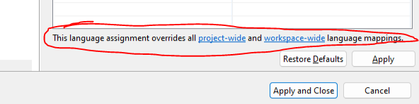

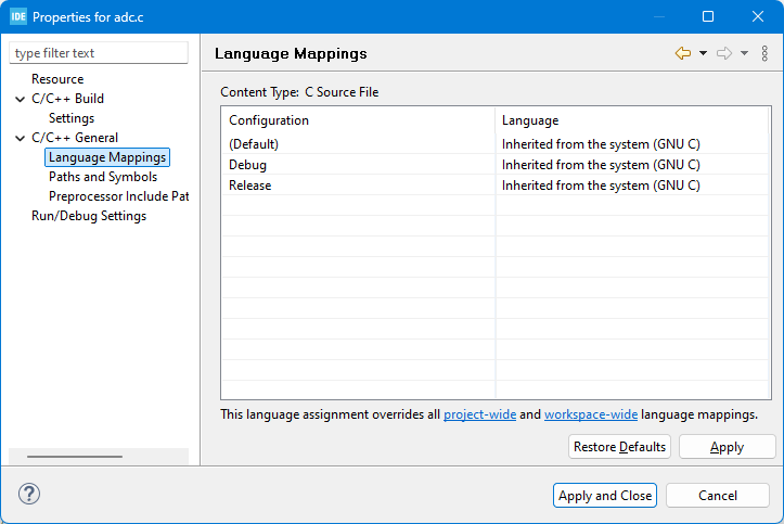

If you right-click the file and choose 'Properties', there's this:
Looks like generic Eclipse ?

You can exclude the c file from build and include it in a new cpp file. That's an ugly workaround.
@ferro wrote:
"Compiler options can be modified per file."
Where, how ?
Rightclick the file. Click properties. Click C/C++ General. Click Language mappings. Then select GNU C++ from the drop down menus.

ferro
ferroAuthor
Lead
December 5, 2024
Here, the original C recipe is used despite setting C++ in mapping.
