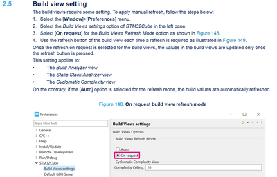

Hello. I could find the Build analyzer window, but it is blank, even after, build, run, or debug... any idea? Thanks

Hello @SMedi.3
You have to click on the "Refresh" button:
Please, refer to the User Manual, section 2.5 where this new button is explained and how you can change the behavior:
Best Regards.
