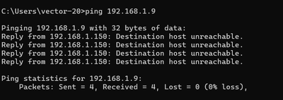

Visitor II
October 20, 2024
Hi @Laurids_PETERSEN
I am using STM32H730 controller with Zephyr RTOS and in XiP mode. My problem is that the transmit on ethernet is not going out from the device.
Following is the MPU configuration of the device.
SCB CCR: 00070210, DCache: 1, ICache: 1
MPU 0: Adr:90000000 - Value:(0202002D) XN:0 / AP:2 / TEX:0 / S:0 / C:1 / B:0 / SRD:0x00 / SIZE:0x00800000 / EN:1
MPU 1: Adr:24000000 - Value:(110B0025) XN:1 / AP:1 / TEX:1 / S:0 / C:1 / B:1 / SRD:0x00 / SIZE:0x00080000 / EN:1

Visitor II
June 26, 2025
I am getting this error please let me know if you know.
