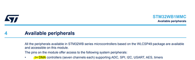

Colleagues.
The STM32Cube_FW_WB_V1.20.0 library for STM32Cube_MX version 6.12 allows me to create DMA2 channels for B-WB1M-WPAN1. However, the startup_stm32wb1mxx_cm4.s and stm32wb1mxx.h files do not contain DMA2 interrupt vectors.
Error[Pe020]: identifier "DMA2_Channel4" is undefined
What should I do?

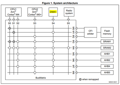

Hello @pm_interrupt_vect and welcome to the Community ;
I apologize for my late reply.
According the reference manual RM0473 Rev 10 and DS14096 - Rev 7  that only DMA1 is supported by STM32WB1MMC.
I reported the STM32CubeMx issue internally.
Internal ticket number: 195174 (This is an internal tracking number and is not accessible or usable by customers).
Thank you.
Kaouthar
