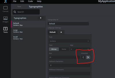

I'm using a textarea widget with a wildcard, but as you can see in the image, the text appears inverted
Any way to solve this?

In your Text/Typography tab in the designer, check that all your fonts are generated LTR instead of RTL.
