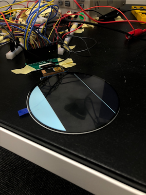

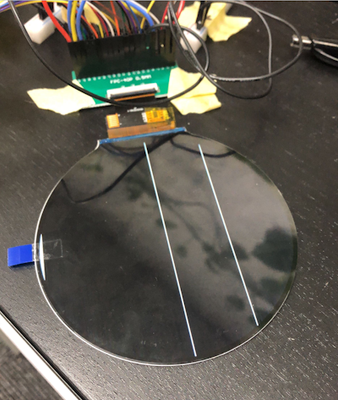

3. I have very strange rainbow lines behaviour
Currently I am running a 35Mhz clock. The 35Mhz clock was derived from the linux device tree overlay for the HD40015C40-Y display.

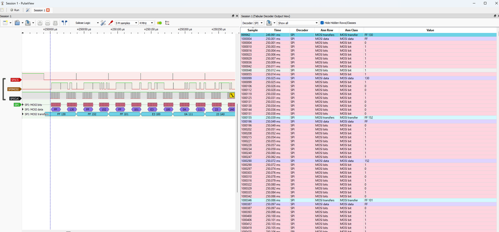

4. Things I do know: SPI transmission definitely works. There are physical signals for the LTDC pins coming from the STM chip as I checked with an oscilloscope.

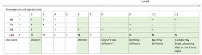

I've had different permutations and combinations of Vsync and it has yielded different artefacts such as the number of lines appearing. However none of this reflects what my GUI design is supposed to look like.
I have the image even TouchGFX GUI animating in the simulator but there is no change on the display.
So it seems to be stuck somewhere between SPI initialization and LTDC? If I turn off the power, it will lose this state. So SPI init seems to be working to an extent, however I cannot see the desired image. Anyone have any ideas?

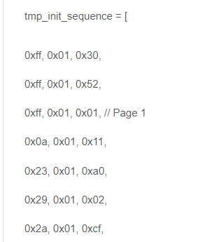

To do better debugging I reduced that list of registers initialization, and I verified that the minimal registers initialization to have the display working properly is the following one (register, datalen, value):
tmp_init_sequence = [
0xff, 0x01, 0x30,
0xff, 0x01, 0x52,
0xff, 0x01, 0x01, // Page 1
0x0a, 0x01, 0x11,
0x23, 0x01, 0xa0,
0x29, 0x01, 0x02,
0x2a, 0x01, 0xcf,
0xff, 0x01, 0x30,
0xff, 0x01, 0x52,
0xff, 0x01, 0x03, // Page 3
0x82, 0x01, 0x1f,
0x83, 0x01, 0x1f,
0x85, 0x01, 0x0a,
0x86, 0x01, 0x0a,
0x87, 0x01, 0x0c,
0x88, 0x01, 0x0c,
0x89, 0x01, 0x0e,
0x8a, 0x01, 0x0e,
0x8b, 0x01, 0x10,
0x8c, 0x01, 0x10,
0x8f, 0x01, 0x1f,
0x90, 0x01, 0x1f,
0x93, 0x01, 0x02,
0x94, 0x01, 0x04,
0x9a, 0x01, 0x05,
0xff, 0x01, 0x30,
0xff, 0x01, 0x52,
0xff, 0x01, 0x00,  // Page 0
0x36, 0x01, 0x0a,
0x11, 0x01, 0x00,
0x29, 0x01, 0x00]
I cannot shrink the list more than this, in particular, if I comment out the PANELU2D1~44:80H~ABH on Page 3, there is an effect similar to the one you showed in your photo.

Regarding, the minimal init sequence you are sending the bytes with 9 bit words in STM32?
9bit cmd + 9bit parameter? + 9bit parameter? How is this achieved?
 compared to the Write_Reg_3052(cmd,param);

Okay, latest update:
Some extra information to bring up. I am using the STM32U5G9J-DK2 with the pinout modified to work on the display. I've modified the code such that it should work with a 720x720 framebuffer and do SPI init on the display. So in a sense I am not starting the project on a new board. That said, I don't believe this should cause the display to not work. If you create a project based on this in TouchGFXDesigner, you will end with the same base code I have.
I've purchased the Adafruit Microcontroller to compare. My SPI init sequence is 1 to 1 according to logic analyser with the exception of chip select not being down the whole time, I changed that and it didn't make a difference.
The next thing I did was start probing the clock signals on the Adafruit. I found it to be running at 12Mhz. I was using the rainbow demo and it was flickering however I think this is a problem with the code Adafruit provided and not so much the init or display itself.
I also measured the colour signals on the oscilliscope and found that to be sending data as expected.
And then I found out that my STM program is not sending any colour signal on the oscilloscope and that the Model::Tick() only runs once and then does not continue... This seems to be a problem with my codebase so I decided to start a new STM project.
Now I have colour signal again however... it is still the white stripes. I am at square one again.
The display refuses to display any of the LTDC signals despite receiving valid PLK, VS, HS clock signals and even colour signals (measured on oscilliscope).
The only signal I haven't been able to verify is the DE signal due to the small probe to measure. Even then, I think it is unlikely data enable isn't working.
Would anyone know how to extract the Vsync, Hsync FP and BP values from the adafruit. If it makes sense, it should be the same as the ones provided by Adafruit themselves and I should not have to investigate this.
Maybe some things I can try is bit banging directly to the RGB outputs. Or somehow testing LTDC before entering TouchGFX and RTOS loop, if that is possible?
Otherwise mostly, I'm not sure where to go from here.
