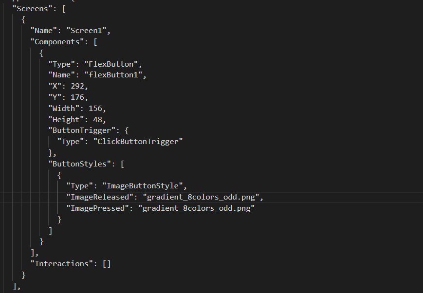

In the meantime, a work-around could be to open your .touchgfx file and modify the ButtonStyles>ImageReleased and ButtonStyles>ImagePressed paths, in order to insert the name of your image there. That will force TouchGFX to use your image, like this :
