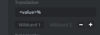

To display something like "15%" or "2%", you can simply add a wildcard to your textArea followed by the % sign :

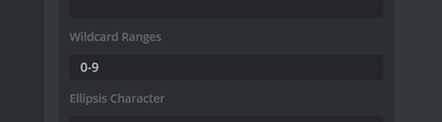

Make sure to add "0-9" in the wildcard range of the typography used for the textArea :
