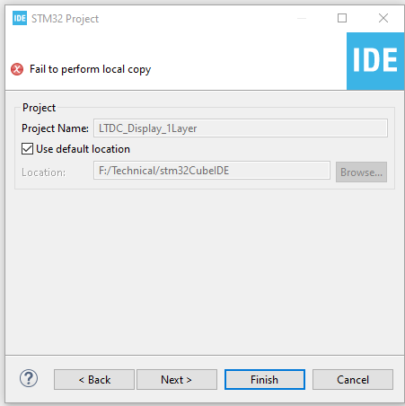

I'm using stm32CubeIDE V1.9.
I wanted create new project example based on "LTDC_Display_1Layer".
Before - I deleted all folder related to this project (because I created it already and did something into but wanted start again from a fresh project) .
I also installed CubeIDE new.
Now I still get this stupid error, see screenshot below.
What can I do? New installation of V1.9 and new start of computer does not work...
Thank you
Best answer by FBL
Hello @pk84​
Do you mean you have deleted examples from the firmware package? If so, you need to redownload a new one or clone a repo from Github.
Try creating the project in a different location or directory to avoid conflicts and errors from the previous project.
Hope this helps!

I think, I've deleted the LTDC examples itself, where or how can I load it? (with other examples I can create a new project)
Foued_KH
February 24, 2023
Hello @pk84​ ?
You can refer to the CubeFW to find the LTDC examples.
Try to download the LTDC examples from Git or download a new FW from ST site .
Foued
FBLBest answer
February 24, 2023
Hello @pk84​
Hope this helps!

pk84
pk84Author
February 24, 2023
I have deleted the whole folder and content in C:\Users\.....\STM32Cube\... so the IDE had to re-download everything, and now it works....
Of course, downloading the LTDC examples from Git would have been a solution too (I didn't know that these examples are available on Git...)
