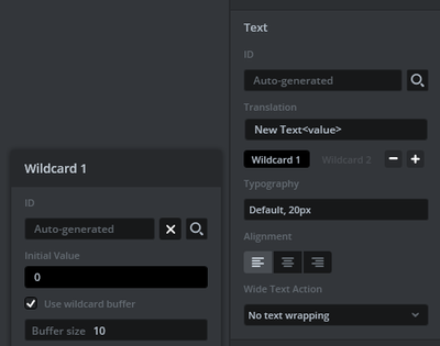

    Hello @vasilevskialeksandar,
    Did you think about checking the Use wildcard buffer check box and giving an initial value to the wildcard, like here:
    Best regards,
    Best regards,
    December 4, 2023
    Thanks. It works this way. I was not aware that Wildcard 1 is clik-able.
    Also I needed to remove textArea1.setWildcard(myBuffer); //Note if some beginner read this thread.
    Need to refresh my C++ knowledge to understand why my old way does not work since it is basically same thing.

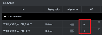

    Hi @vasilevskialeksandar ,
    I think your code does not work because you do not set TypedText for the textArea1.
    TypedText must contain magic code '<>' in order for Gfx to display what you copy into Wildcard buffer.
    What I do is, in the Text View Tab, I create TypedText for each alignment containing '<>' only:
    Then, you use generated TEXTS::Ids ( TextKeysAndLanguages.hpp ) to initialise textArea1 :
    void MainView::setupScreen ()
     textArea1.setWildcard ( myBuffer );
     textArea1.setTypedText ( TypedText { TEXTS::T_WILD_CARD_ALIGN_LEFT } );
    After that, your code should work as intended:
    void MainView::update_text_field ( uint16_t new_val )
     Unicode::snprintf(myBuffer, 20, "%02d",new_val);
     textArea1.invalidate();
    Ferro
