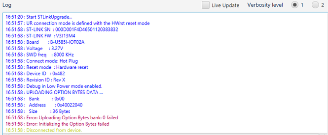

I've added the OEM2KEY AND OEM1KEY to the RDP Level 2 protection in order to perform the same steps as in the 'Getting started with STM32CubeU5 TFM application' for enabling Production Mode.
Following the steps and executing the HARDENING.SH file, I'm no longer able to modify the board or revert to RDP level 0. It's showing me the following error: Error: ST-LINK error (DEV_TARGET_NOT_HALTED)
If I enter Hotplug mode, it shows me the following: Error: Uploading Option Bytes bank: 0 failed Error: Initializing the Option Bytes failed.
Any help?

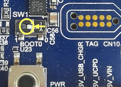

Hi @Istillaga,
If TZ is enabled we need to boot from the RSS as follow:
- STEP1: Ensure the switch SW1 (BOOT0 pin) on B-U585I-IOT02A board is on position 1 to boot from RSS (see below the yellow arrow).

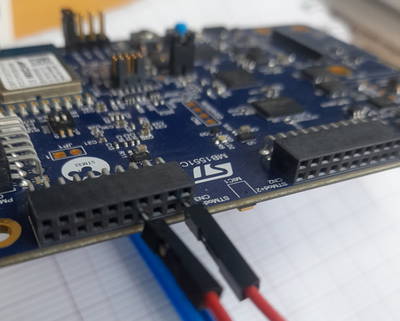

- STEP2: Connect TAMP_IN8 (PE4 on CN3 pin 11) and TAMP_OUT8 (PE5 on CN3 pin 14) on the B-U585I-IOT02A board (as follow)
- STEP3:

Hello @Istillaga
- Can you check that the tamper pines are connected before running the regression script ?
It is needed to connect TAMP_IN8 (PE4 on CN3 pin 11) and TAMP_OUT8 (PE5 on CN3 pin 14) on the B-U585I-IOT02A board, to allow the application to run.

Hi  @CMYL
I have executed the commands and obtained these results:
$ STM32_Programmer_CLI.exe -c port=swd mode=UR -unlockrdp2 0x12345678 0xABCDEFAB -------------------------------------------------------------------
STM32CubeProgrammer v2.16.0
ST-LINK SN : 000D001F4D46501120383832
ST-LINK FW : V3J13M4
Board : B-U585I-IOT02A
Voltage : 3.28V
Voltage : 3.28V
Unlock RDP2 password succefully done!
Error: ST-LINK error (DEV_TARGET_NOT_HALTED)​
$ STM32_Programmer_CLI.exe -c port=swd mode=hotplug -r32 0xE0044104 4
Voltage : 3.28V
SWD freq : 8000 KHz
Connect mode: Hot Plug
Reset mode : Software reset
Device ID : 0x482
Revision ID : Rev X
Device name : STM32U575/STM32U585
Flash size : 2 MBytes (default)
Start Address : 8000000
Device type : MCU
Device CPU : Cortex-M33
BL Version : 0x0
Debug in Low Power mode enabled
Reading 32-bit memory content
Address: : 0xE0044104
0xE0044104 : CC0C0F68
$ STM32_Programmer_CLI.exe -c port=swd mode=hotplug -ob rdp=0xDC
Voltage : 3.28V
SWD freq : 8000 KHz
Device ID : 0x482
Revision ID : Rev X
Device type : MCU
BL Version : 0x0
UPLOADING OPTION BYTES DATA ...
 Bank : 0x00
 Address : 0x40022040

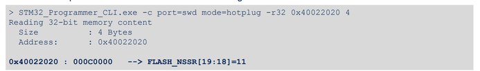

April 22, 2024
hi @Istillaga
can you check that:
- OEM2LOCK and OEM1LOCK bits in the FLASH_NSSR register are set to be sure that OEM1KEY/OEM2KEY are already provisioned
> STM32_Programmer_CLI.exe -c port=swd mode=hotplug -r32 0x40022020 4
the result should be as follows:
- Are you sure that the OEM2KEY password is 0x12345678 0xABCDEFAB ?
Check that PH3-BOOT0 PIN of the board is connected to VDD.
best regards

Hi @CMYL
I am sure my password is 0x12345678 0xABCDEFAB.
I have executed the command and I obtained the following result:
 Address: : 0x40022020
Error: failed to read the requested memory content
