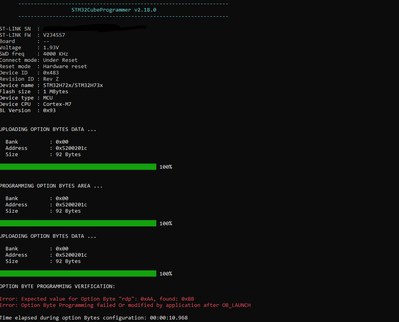

2024-12-20 1:07 AM
Thanks for support.
I try with the command but I still have the same error:
Have you got another idea ?
Regards,
