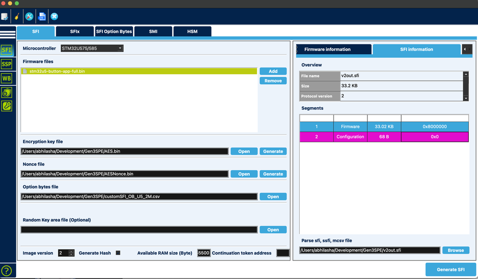

I generated an SFI image for STM32U585 based on my application. here is the details:
Firmware information:
SFI image details:
However, when I try to install this image, it fails with the error:

15:12:10:335 : Error: Execution of RSS CMD failed, returned value = 0x1
- The license part looks ok to me.
I am not able to determine if there is an issue with my firmware image or the way I am generating my image.
Any help would be appreciated. Thanks!
2025-01-20 2:44 AM
It seems like the error occurs while processing the second area which contains the Option Bytes to set.
The Option Bytes template file for U5-2M RSSe SFI v4.0.0 is as below:

Is the format different from the one you used when creating your SFI image?

Here it is in plain text:
main$ cat customSFI_OB_U5_2M.csv
OPTR,0x9DA9F9AA

I think the issue comes from the RDP value in OPTR register. The minimum RDP value that can be set for a SFI is 0.5 (0x55) because the goal of the SFI procedure is to protect the user's firmware from the contract manufacturer.
After a SFI procedure, the contract manufacturer shouldn't be able to access the user's assets, so the RDP level must be higher than 0 (RDP 0 opens Secure and Non Secure debug).
You can find more information on this in the Application Note AN4992 :
