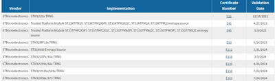

Hello @Jocelyn RICARD , documentation itself was clear but how about the RNG certification is it already completed?
Jocelyn RICARD
August 29, 2024
Hello  @Jouni_S ,
The AN4230 is not yet published with update because it is waiting for other inputs for other STM32.
Now, certification documents are available.
You can find here the list of certifications available.
Here is a capture
Then from this page you can access to certification documents.
For the U545 this is this page
From this you can access to the associated document by clicking on Public Use Document.
In this document you will find the RNG configuration used.
I hope this answers your question
