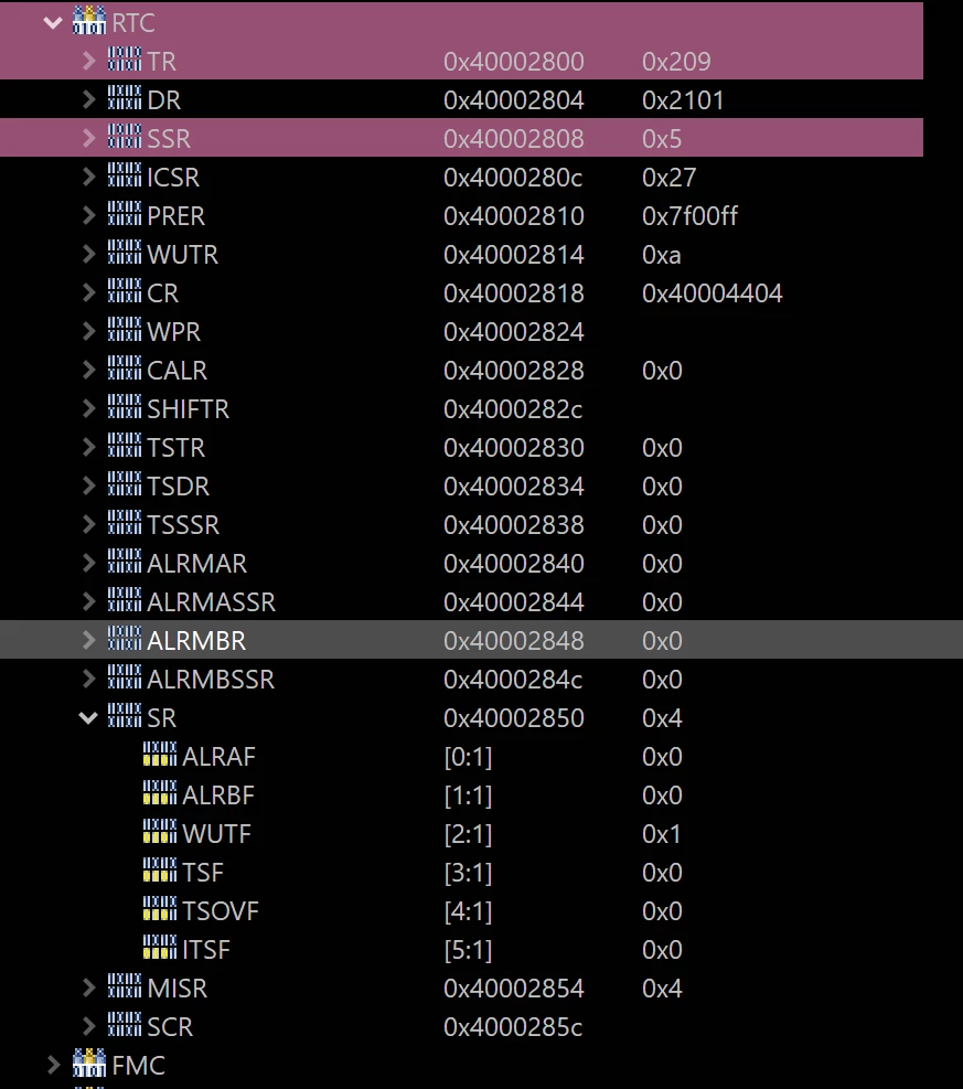

Final point, the code we're using to periodically wake the system only sets RTC_FLAG_WUTF 32 times and then stops. We use this flag to check for a wakeup from the RTC so we can run our checks and immediately shutdown. What could be causing this? The most obvious culprit is some RTC register incrementing and not being reset but a glance at the registers after a few cycles doesn't show anything interesting.

The code that checks for an RTC wakeup. This is in main() after all the Cube MX generated peripheral initialization calls:
 hrtc.Instance = RTC;
	if (__HAL_RTC_WAKEUPTIMER_GET_FLAG(&hrtc, RTC_FLAG_WUTF) != RESET)
		// The MCU woke up from the RTC wakeup timer
		MX_RTC_Init();
		standby();
Thanks in advance for any help!
