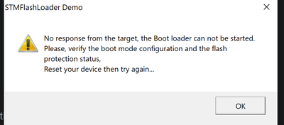

I am trying to enter USART1 bootloader (Pin PC4 and PC5) for STM32G474RCT6 MCU
We are following AN2606 and tried to keep the option bit configurations as per the highlighted row under pattern 14
Bit status:
The Boot0 pin (PB8) is NOT  pulled down with registered and is tied to VDD line via a push button
To enter the bootloader, we press the the button connected to PB8 and the reset pin in a sequence like below:
1. Hold the boot button
2. Hold reset button
3. Release reset button
4. Release boot button
We are using the Flash Loader Demo exe for flashing
Getting below error while after applying above mentioned sequence of boot and reset pins
Please confirm if the above steps are correct and what must be done to enter the boot loader
Also, is there another way to confirm if device is in boot mode config

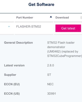

That utility is no more recommended for new design as below, please use STM32CubeProgrmmer instead  and let us know if the behavior is the same ?
Hope it helps ,

Connected how and with what?
CMOS level signals are not RS232 compatible
Noise on other inputs might be taken as first-contact, say a GPS/GNSS chirping continuously from startup.
Reset and try again
