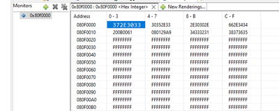

How are you verifying the page is not erased? What tool and memory addresses are you looking at?
Adriano Melis
February 21, 2024
I am monitoring the page content using the Memory renderer of STM32Cube Ide, there are values different from the erased value 0xFFFFFFFF
Adriano Melis
February 21, 2024
February 21, 2024

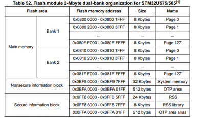

Hello @Adriano Melis
The page 127 in bank1 is in 0x080F E000 - 0x080F FFFF
the screenshot you showed, does not show page 127

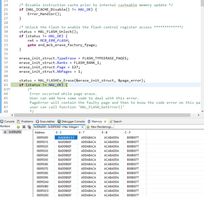

Adriano Melis
February 21, 2024
Adriano Melis
February 21, 2024
my bad. this is an actual screenshot: Flash erase has been executed, FLASH content is unchanged.
(status value is HAL_OK)
February 21, 2024
I tried to reproduce your issue using the FLASH_EraseProgram example in STM32U5CubeFW, however, page 127 was erased successfully and I couldn't reproduce it
Maybe share a minor project to reproduce it on my side.
