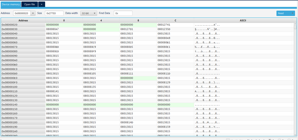

I'm encountering an issue with my STM32H750 MCU.
I download my program to the flash via the UART interface using STM32CubeProgrammer. The MCU can work well for a few days, but suddenly crashed. This problem occurred randomly on 2 out of 15 boards with the same hardware and software design.
Here are diagnostic steps taken:
(1)Connecting via the SWD interface using J-link and found option bytes(0x52002000) is able to read, but flash bank 1(0x08000000)is unable to read
Checked the read protection was set to level 0. J-link log:

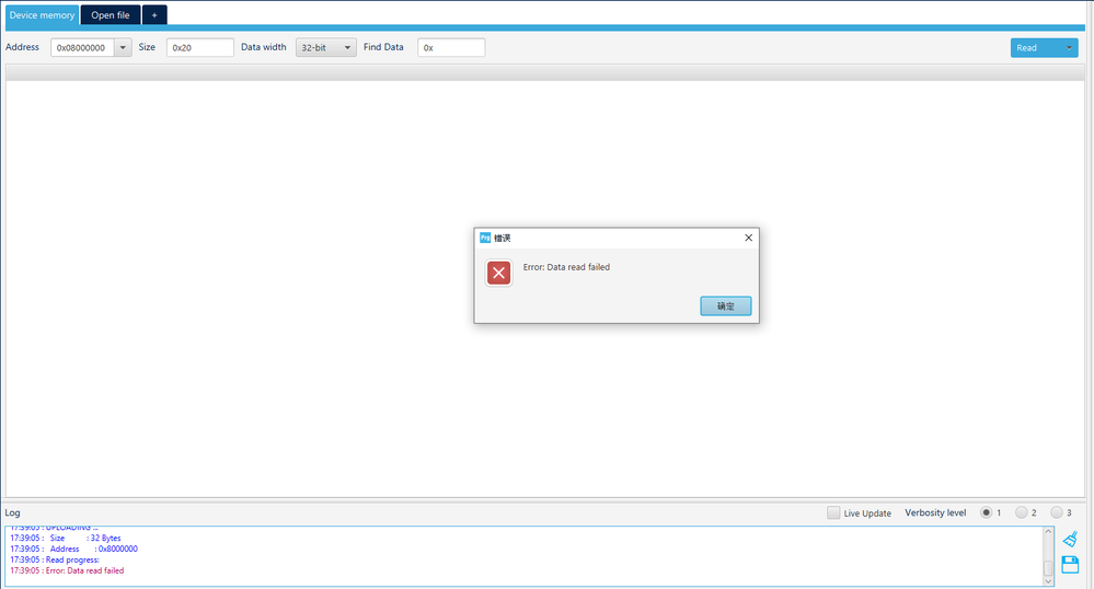

J-Link>mem 0x08000000 10
Could not read memory.

(2) Connecting via the UART interface using STM32CubeProgrammer, but can‘t receive apply. Log:

(3)Erasing full chip  via the SWD interface using J-flash(J-flash->Target->Manual Programming->Erase Chip), and the MCU is back to normal.
Note: As there are 2 boards with the same problem, one has recovered to normal, while the other remains in the error state.
Given that the read protection is set to level 0 , I am puzzled as to why flash bank1 cannot be read.
Has anyone encountered a similar problem before? Any suggestions or advice would be greatly appreciated.

  15:46:53:672 : r ap 0 @0x08000000 0x00000100 bytes Data 0x20036450
  15:46:53:672 : Error: Data read failed

The first 32 bytes of the MCU's flash bank cannot be read, but the subsequent parts can be
0x08000000-0x0800001F read fail
0x08000020-0x0801FFFF read ok
