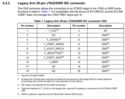

What is the TVAPP app pin? This doesn't appear in the V3SET user manual. Did you mean T_VCC? Assuming so:
If it's delivering 5V to the programmer, you have a hardware problem. That pin should be tied to VCC you're using on the MCU. If it's 5V, that explains why the chip isn't responding as voltage should be under 3.6V.

Pin 1 of what connector?
Again, "TVAPP" doesn't appear in the user manual or the pinout. Did you mean T_VCC? Or where did you find the pin name TVAPP?
Are you referencing the SWD connector or an ARM JTAG connector (20pin)?
What is pin 1?
On STM SWD debug connector it is not connected. On an ARM 20pin JTAG adapter it is VDD.

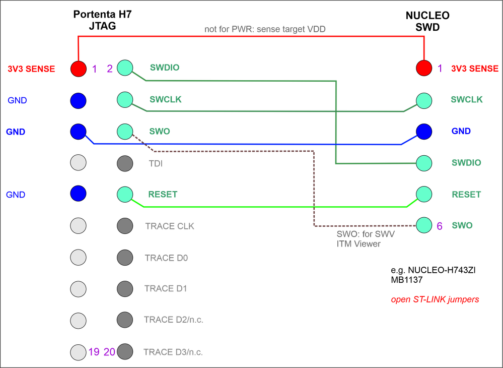

Actually, the debugger ST-LINK (and even for 20pin ARM JTAG connector) does not provide the power for the board. Instead, these VDD pins are used to sense the power on the board. A debugger will not power the board, it wants to see the VDD power at the board via an input pin on debugger.
It sounds to me as well: you provide MCU VDD (and on board) as 5V (not 3.3V).
What is your schematics, pinout for the debugger connection?

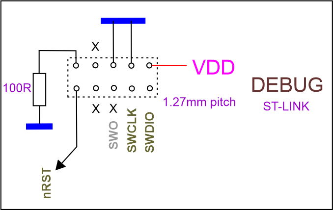

Here my SWD connector for an ST-LINK debugger.
The VDD is not provided by ST-LINK: it is a sense signal ("what is target VDD?") as well as the 100R to GND: "is there a connection?".

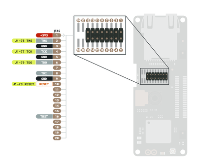

Just to clarify, indeed it is the VDD pin. On the portenta H7 it would be the 3V3 line, pin #1 of the JTAG header. I hope that clears it up for everyone but can see that everyone already knows what I mean. See below image of the H7 JTAG pinning.
The MCU, PMIC and JTAG on my board are wired exactly the same as in the H7 and ethernet shield and so would hope and expect the same functionality and result. The VDD pin on the H7 ("+3V3" line) remains at 0.0V until the MCU is programmed and code uploaded to turn on the PMIC regulator that supplies this line. So any sensing by the programmer of VDD pin #1 of the JTAG connector will only turn up 0.0V from start to finish.

the debugger/programmer needs at least two "sense" signals:
  • pin 1: it is sense input for programmer to measure target voltage
  • pin 9: goes usually via 100R to GND: it is sense for "connection done" (not a signal GND!)
Does your board provide the VDD (on board) at this pin 1?
Or do you expect pin 1 is a power input from programmer? (which is not!)
If you do not put the VDD on board to pin 1 - the programmer will never see your board.
