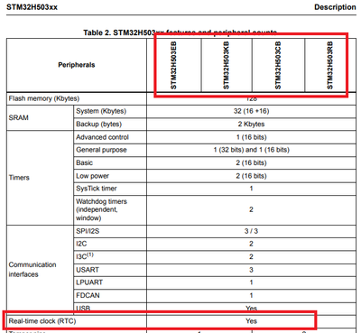

Second, and regarding your last question, this information is available in the STM32H503 datasheet / table 2 :
PS: This is NOT an online support (https://ols.st.com) but a collaborative space. So please be polite in your reply. Otherwise, it will be reported as inappropriate and you will be permanently blacklisted from my help/support.

Ok thank you. But since STM32H503 device features already an RTC, why do you need to connect an external RTC then?

‎2024-06-18 04:01 AM
But becarefull, with 32 pin package VBAT pin is not available, so you can't back the time up with an external battery. VBAT is tied internally to VDD in that case.

‎2024-06-18 04:27 AM
Okay. Thank you for the information. For our application, battery backup for RTC isn't required.
