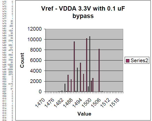

Problem type - ADC readings excess uncertainty when reading internal reference (channel 17) - got to this point after excess ADC reading uncertainty on device pins, trying to isolate cause.
Hardware Details - small 2-layer board (about the size of a LQFP48/DIP adapter module), VSS and VSSA (4 places) to ground within a few mm, VDD and VDDA (4 places) each with 0.1 uF 0805 decoupling cap within a few mm, then on to 3.3V power source. Reset is pulled up (47K) to 3.3V power source. PA14/PA15 tied to STLINK device (STLINK device is not providing power to the target.) BOOT0 tied to 3.3V source. All other pins open.
Software details - bare-metal configuration of CPU - 24 MHz CPU clock (RC, not crystal)

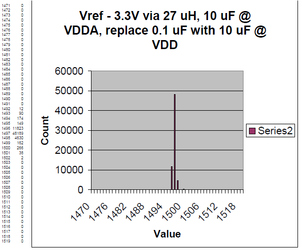

Considerable progress - added 27 uH 0805 inductor in series between VDD_1/2/3 and VDDA, modest improvement in distribution of the samples was seen. Then changed the decoupling cap between VDDA and ground from 0.1 uF to 10 uF (ceramic 0805 6.3V) and saw a dramatic improvement. Finally changed 0.1 uF decoupling cap near VDD_1 from 0.1 uF to 10 uF, and saw a further modest improvement in distribution of samples. Lesson learned - can't take the value of decoupling caps in this area for granted!
Reading Vref 65k times with 239.5 sample time and 12 MHz ADC clock
First plot is after changes (MCU now has 10 uF @ VDD_12 to ground; VDDA supplied by same 3.3V source, but with 27 uH series inductance followed by 10 uF @ VDDA to ground).
Second plot is before changes (VDDA tied to VDD_1, 0.1 uF at both pins to ground)

ST appnotes suggest 1uF//10nF parallel combination to VDDA-VSSA. Series inductance can help. But ADC "noise" highly depends on external conditions, like quality yours 3.3V supply, grounding scheme etc.
Yours results with 27uH, looks nice. I don't believe it can get any better.
