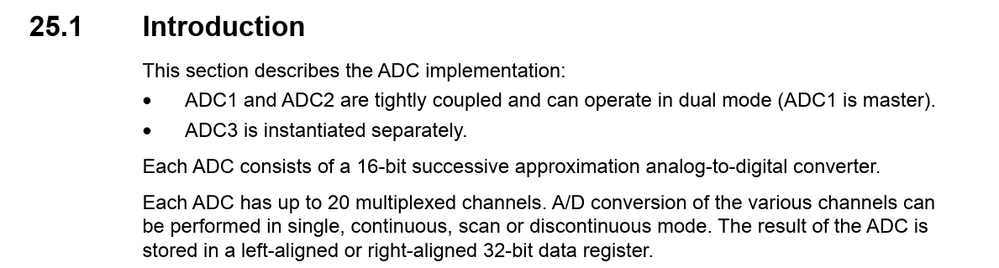

Below shows  having 3 of16-bit ADCs - Are they independent?

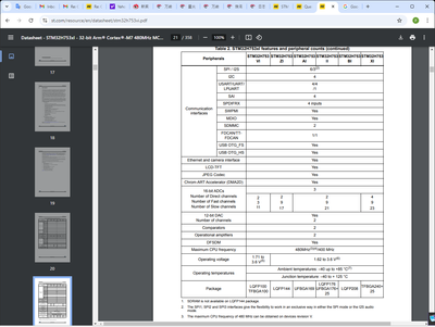

Below shows STM32H753ZI has 2 direct channels, 9 fast channels, 17 slow channels.
                                              Are they independent? Or only  2 direct channels independent?
Thanks
Rong
yes.
yes, independent .
see AN5354 :
You should read yourself, see rm :
So 1+2 can work in dual mode...but also separate.

.1. What means "ADC1 and ADC "tightly coupled"? Can they be coupled and also decoupled?
 2. All ADCs have 2 Direct channels. What does "direct" mean?
3. Can all ADC sampling be simultaneously under the same clock?
Thanks,
Minor corrections to the previous question submission:
1. What means "ADC1 and ADC2 "tightly coupled"?
2. Can they be coupled and also decoupled?
3. All ADCs have 2 Direct channels. What does "direct" mean?
4. Can all ADC's channels sampling be simultaneously (one channel in each SAR ADC at a time) under the same clock rate?
