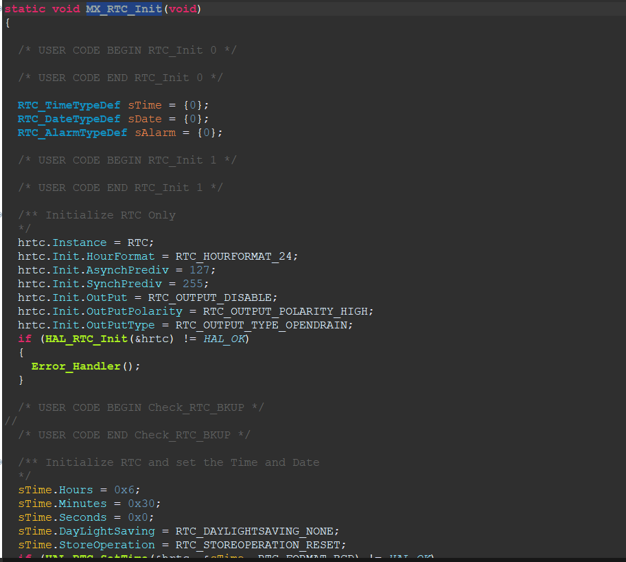

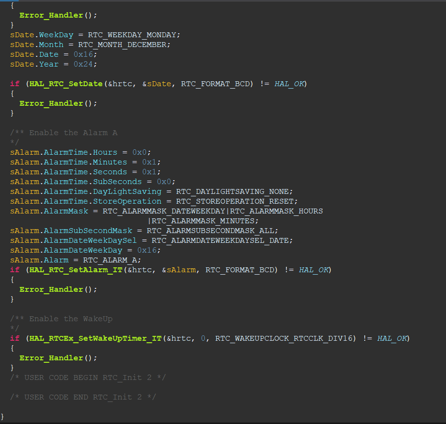

Hello STM32 Community,
I am using the STM32F407G-DISC1 development board and have successfully implemented an RTC alarm that triggers every minute. The RTC is configured to use the LSI (Low-Speed Internal) clock signal.

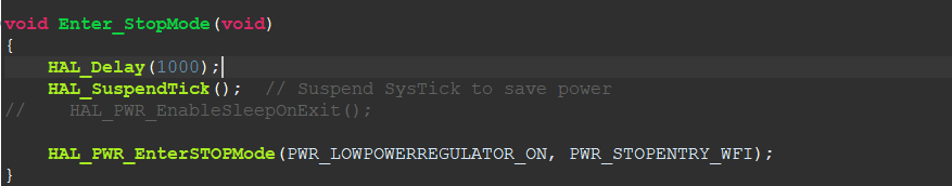

My goal is to have the microcontroller enter sleep mode and wake up after 3 minutes using the RTC wake-up feature. However, when the MCU enters sleep mode, it wakes up prematurely, within only 2 seconds, instead of the expected 3-minute wake-up period.
I would appreciate any assistance or insights into resolving this issue. Has anyone encountered a similar problem when using the LSI clock for RTC wake-up, or can you suggest any potential causes for this behavior?
Thank you in advance for your help!ioc configurationioc configurationRTC init_1RTC init_1RTC init_2RTC init_2Stop functionStop functionwake up functionwake up function
1 reply
December 24, 2024

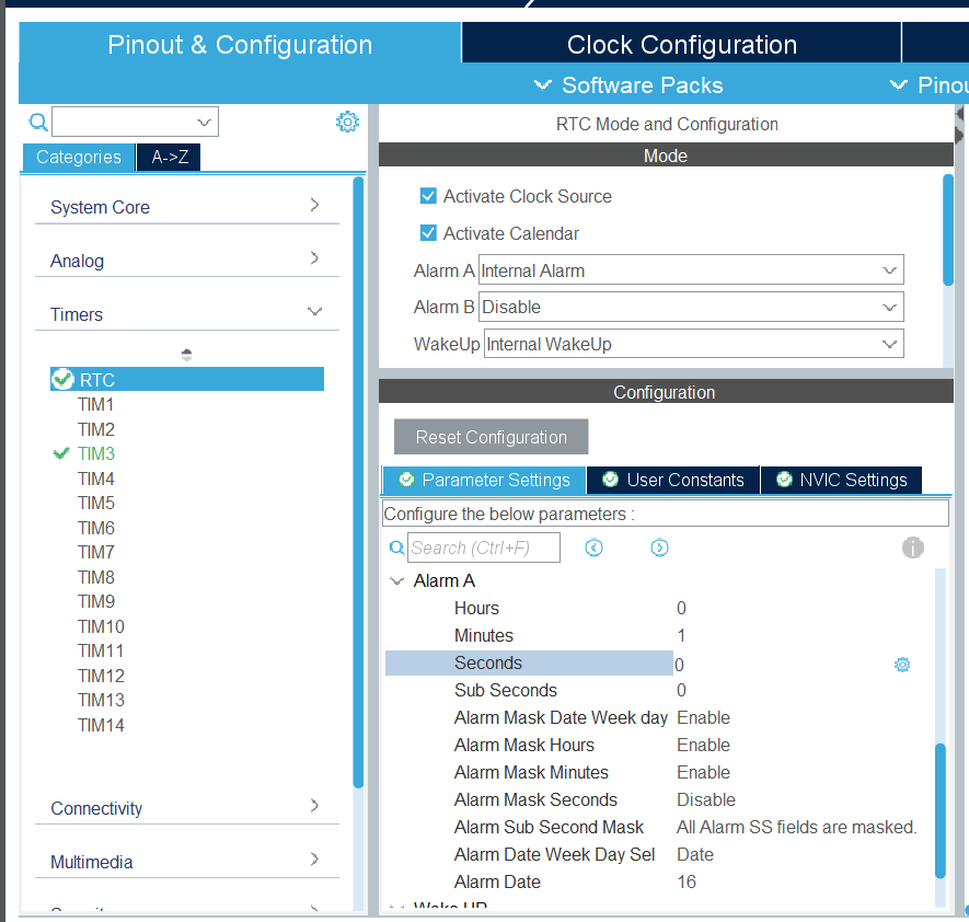

Procedure for waking up in the future:
  • Get the current time.
  • Change the time to 3 minutes in the future and set the alarm to wake up then.
  • Since you want to wake up when minutes and seconds match, mask everything except minutes and seconds. Your current mask ignores minutes.
Your current code wakes up when seconds = 1 and ignores minutes.
