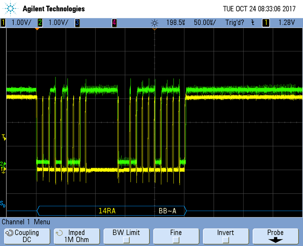

The timing seems to be ok. I've added the slave responds  directly in the
HAL_I2C_AddrCallback the I2C Slave respond.
void
HAL_I2C_AddrCallback(I2C_HandleTypeDef *hi2c, uint8_t TransferDirection, uint16_t AddrMatchCode) {
if
(TransferDirection == 0x00) {
//Write Access
            osSemaphoreRelease(semI2Cid);
 else
//Read Access
            uint8_t test[1];
            test[0]=0xBB;
            HAL_I2C_Slave_Sequential_Transmit_IT(&hi2c1,test,1,I2C_FIRST_AND_LAST_FRAME);
        while
(HAL_I2C_GetState(&hi2c1) != HAL_I2C_STATE_READY);
            HAL_I2C_EnableListen_IT(&hi2c1);
With clock stretching:

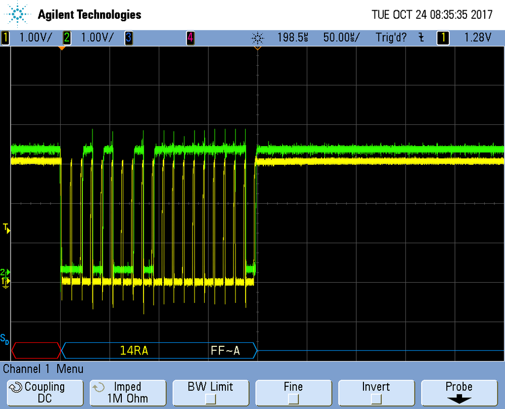

Without clock stretching:
Could it be that the HAL_Library doesn't work without clock stretching in slave mode?

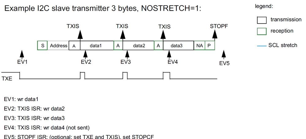

I found the solution to my problem in the reference manual RM0360.

I have the same behavior as you.
Looking at the oscilloscope I see that the slave transmits 0xFF and jumps directly into the I2C error handler. Seems to be that the data are not ready yet to be transmitted.

I use the HAL library. Mainly the function  HAL_I2C_Slave_Sequential_Receive_IT() is used. So I receive sequence for sequence and I write manually in the register I2C1->TXDR the current transmitted value according the reference manual above.
I set the transmitted value in the register after receiving the prior byte.
