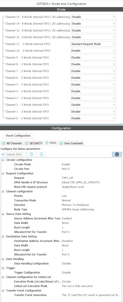

Hello I'm working with a nucleo u575zi-q board where i've to set many GPIO pins in a synchronos way using GPDMA. I've successfully used the DAC and DMA example in the IDE, but Igot stacked with the GPIO output.
I followed the case posted here, triyed with different timers, etc, but couldn't get it on work.
In the user code section on main I stated as follows
/* USER CODE BEGIN 2 */
 uint32_t gpiovales[10] = {0x0,0x01,0x02,0x03,0x08,0x09,0x0A,0x0B}; //I use GPIOB0,1,2, and 4
 HAL_DMA_Start(&handle_GPDMA1_Channel11, (uint32_t) gpiovales, (uint32_t)&(GPIOB->BSRR), 10);
 HAL_TIM_Base_Start(&htim1);
 HAL_TIM_OC_Start(&htim1, TIM_CHANNEL_1);
 TIM1->DIER |= (1<<8); // updates the dma request enable
 /* USER CODE END 2 */
Any help / orientation will be helpful

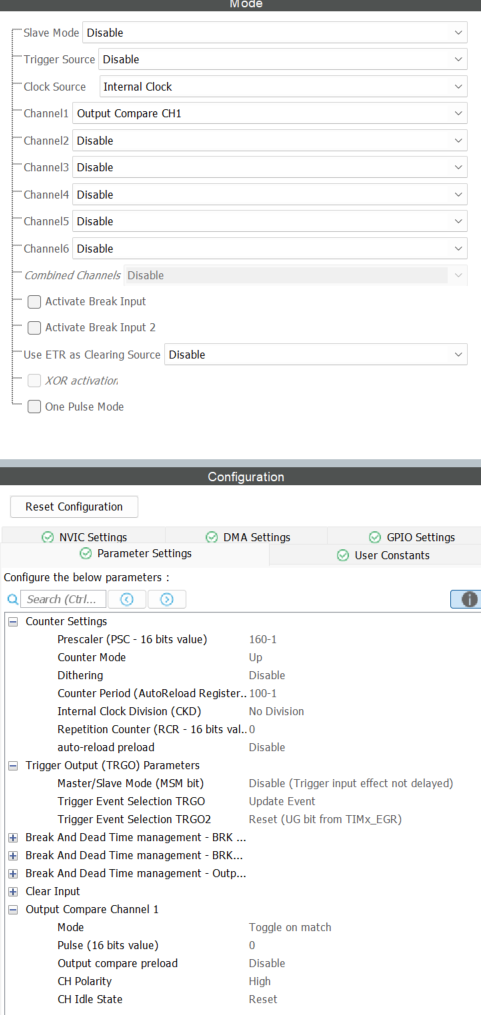

Hello @eosella,
Have you tested that the timers are correctly running and generating the correct update events?
eosellaAuthor
Nov 14, 2024 5:00 PM UTC
I implemented the callback function
void HAL_TIM_PeriodElapsedCallback(TIM_HandleTypeDef* htim)
	if(htim->Instance == TIM1)
		HAL_GPIO_TogglePin(LED_BLUE_GPIO_Port, LED_BLUE_Pin);
but never enters there. Don't know if it's a misunderstanding of which function I should check or if I've misconfigurated / initilized the timer.
mƎALLEm
Nov 14, 2024 5:14 PM UTC
Check first the counter register is it incrementing or not.
Here you are talking about the interrupt. Need to check if you already enabled the TIM interrupt. (NVIC).

Nov 15, 2024 9:20 AM UTC
Hello @eosella,
I've noted that the GPDMA configuration is not totally correct in your .ioc file, you're trying the use GPDMA in standard request mode, however, in the GPDMA1 configuration, "transfer event configuration", you're choosing the wrong configuration for linked list mode:
 Instead, it should be:
Also, you should use HAL_TIM_Base_Start_IT(&htim1) which is necessary for the HAL_TIM_PeriodElapsedCallback function to be called (that's why it never enters there).  The HAL_TIM_Base_Start(&htim1) function only starts the timer without enabling its interrupt, which means the callback function will not be triggered.
