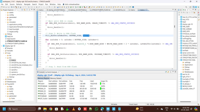

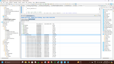

From my understanding so far, I have configured FMC_NOR in the main() function before initializing TouchGFX. I have also allocated space in the linker file, and the images are placed in the EXT_FLASH (rw) section. external loader selected before debug...However, I'm wondering about the pre-assigned data for txbuffer, which is currently set to 0xD20F. Will this automatically be replaced by image data in the memory browser, or do I need to explicitly provide the image buffer here? how to do?

Didn't understand what you want to do.
The philosophy:
The image is already pre-loaded in the Flash NOR at the programming stage of your application (using the Flash loader you developed). The image needs to be located in the Flash NOR.
When your application starts, at the beginning of your main, your application configures FMC interface for your Flash NOR access. So it will be ready before TouchGFX to start.
When TouchGFX starts, it will fetch the image data from the flash NOR (already ready).
