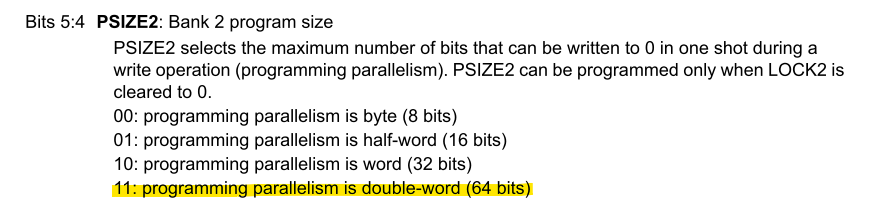

Check also how you erase. Is the "voltage range" parameter good?
I think it is "good". I am using a voltage range of 4 AKA a programming parallelism of double-word. I assume this is OK. There is no documentation in the reference manual about which is "correct" - it is just a tradeoff between timing and power consumption.0693W00000StuF9QAJ.png
