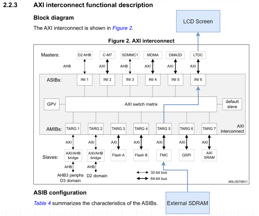

I am using a custom board equiped with a STM32H7, an external SDRAM connected by FMC and a LCD screen drived by LTDC :

I suppose the glitch appears when the other framebuffer is updated in External SDRAM. The write operations from DMA2D bother the read operations from LTDC.
Solution
I started to look at the AXI Interconnect module to configure a Higher Read QoS (Quality of Service) for the LTDC master (Register AXI_INIx_READ_QOS). This didn't change anything.
I then set the bit READ_ISS_OVERRIDE in the register AXI_TARGx_FN_MOD_ISS_BM for the TARGET_5 (FMC peripheral) and it solved the situation. No more glitch.
The reference manual is not really verbose about this bit and what it does. I would like to know more about it in order to understand the consequences for the other of the masters reading and writing through FMC.

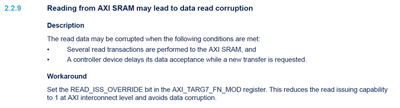

It could be something similar to this errata description:
