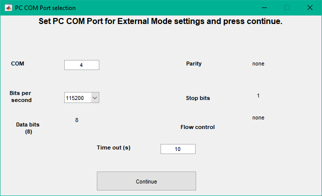

  1. check the properties under Code generation -> interface
  2. press deploy in simulink

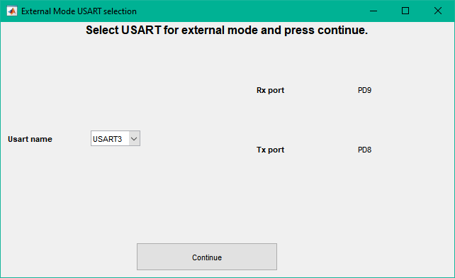

  4. set com port (ST-Link VCP Com-Port)
  5. second dialog popup (select Com Port to use for External Mode on Nucleo [UART3 => PD8&PD9 connected on Nucleo to st-link / CN1] 0693W000007D7uKQAS.bmp
  6. Simulink generate the project
  7. go to your IDE (CubeIDE/µVision or EWARM...)
  8. generate the project --> flash project to your Nucleo... & reset (black button) the nucleo
  9. go to Simulink
  10. press the connect to Target Button
  11. nucleo is connected, you can turn led green on or off with the button
