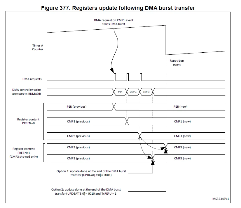

When the preload is enabled (PREEN bit set), there are 3 use cases :
  1. The update is done independently from DMA burst transfers
  2. The update is done when the DMA burst transfer is completed
  3. The update is done on the update event following the DMA burst transfer completion
If you want to update registers on the timer reset, you should have a look on this figure (especially the option 2) :
Did I answer your question ?
