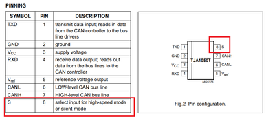

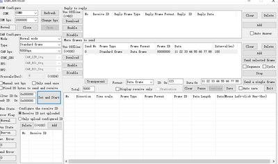

I am trying to run CAN communication (normal mode ) from my discovery board (STM32F407) to USB CAN analyzer via (TJA1050).
I am able to see data on TJA1050 (CAN TX and RX side ) but no data is reflecting on CAN high and CAN low side, so because of no data is showing on CANH and CANL ,no data is reflecting on USB display (note: only rev led is blinking on USB CANAlyzer)
what can be issue ?

Hello @Ash1 and welcome to the community.

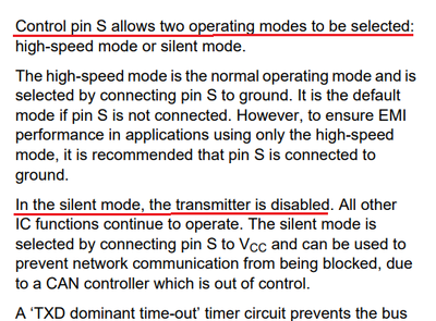

What you did set as voltage level to S pin (Silent mode) of the transceiver?
If you kept S pin not connected or connected it to VDD, the transceiver will be disabled, so you need to pull that S pin to GND.

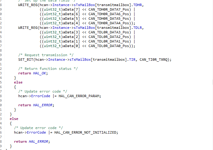

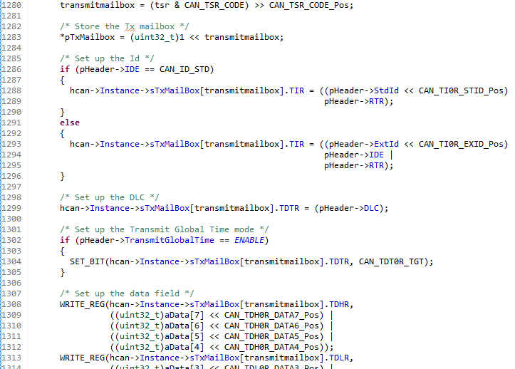

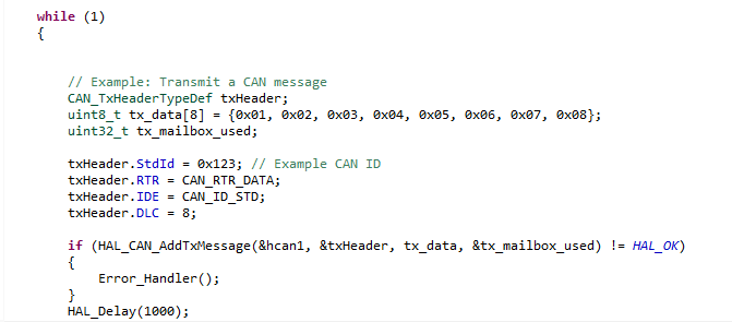

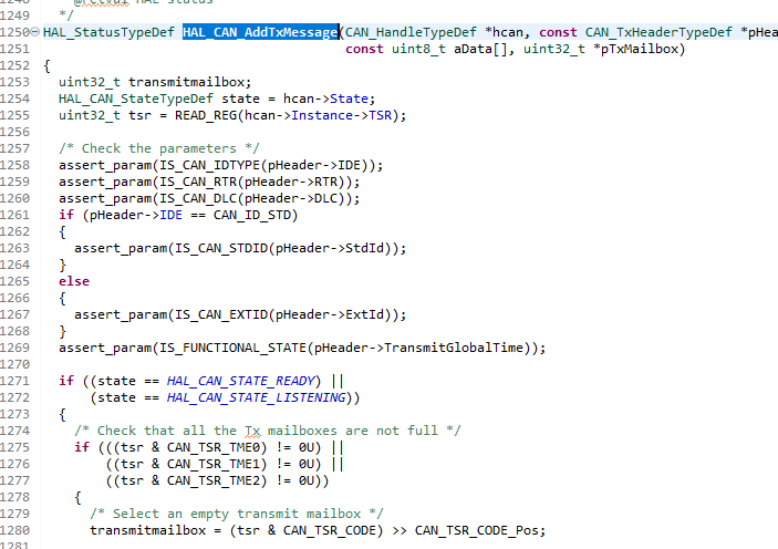

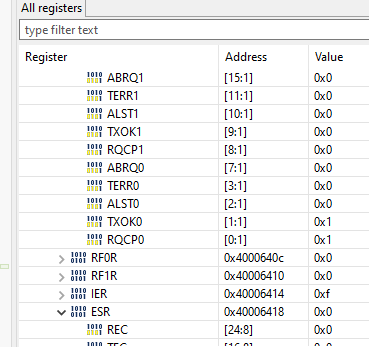

hi Soflit
