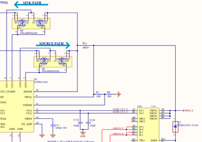

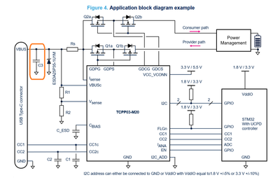

I went to investigate a bit, and even just putting oscilloscope probe on that resistor (R13) used for Isense (which is on this board 47 mOhm) causes over-current detection thus I think the actual problem is that on this board there is no external capacitor on the VBUS line.
In the datasheet of the TCPP03-M20 the block diagram below shows C3 for which datasheet says 100 nF, 50 V :
But on the B-U585I-IOT02A board according to schematic, there is no capacitor, see below:
Anyways, my conclusion is that without hardware changes on this board there is no way to avoid this over-current event when connecting any USB Device.
I don't think USB memory sticks I have are a problem.
I will just do what I already did (basically your workaround 1.) after detecting OCP send the recovery word, which is all supported by BSP driver already.

Hi @milorad
330 pF C1 and C2 capacitors and 2.2 µF C3 capacitor are required by the USB Power Delivery standard.
C3 2.2 µF capacitor ensures a good system robustness. but since it placed after shunt resistor that senses the current it does not impact parasitic OCP.
Internal ticket is reported to dedicated team (197941). Thank you for reporting this.
