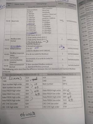

Hi i am New for Arm mbed ,MY project is i want to Control 3 phase induction motor speed using VFD
Here my inovance VFD controlling by (RS 485 Communication Using Max 485 Module) STM 32 Nucleo F767ZI controller,
My slave ID -01,
Baud rate -9600.
modbus data format -8-N-2,
All my VFD Setting was done and Cross checked by USB to RS 485 Driver using modbuspoll Software.(Here i controlling Motor Speed and Direction)
my connection max 485 drive
Nucleo PD_6 (RX)->RO
RE and DE short connect Digital pin PC_8
Nucleo PD_5 (Tx)->DI
VCC connect 5V power supply
A connect VFD 485+
B connect VFD 485-
Gnd connect with GND
this photo is MY VFD Setting
Below i Attached my code
