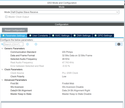

Good afternoon,
I'm using the STM32H723ZG Nucleo Board, and I'm trying to collect data using I2S + DMA coming from a PCM1803AEVM that is  a 24-bit ADC used mostly for audio purposes.
I've set the PCM1803 as controller (MASTER), it is generating the BCK, LRCK and SDO and I can see these three signals using the oscilloscope. I see also the correct frequencies.
BCK:3.072MHz
LRCK: 48kHz
SDO: digital values equal to -1,0.+1 as expected since there is no input signal.
Now, from the STM32 board  I've set the .ioc file related to the I2S part in this way:

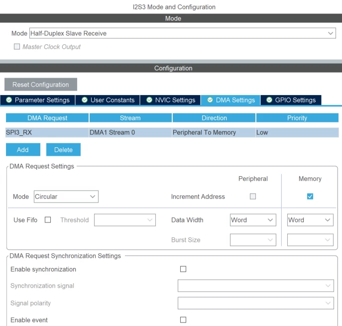

DMA:

At the beginning, can you please check I2S and DMA configurations:
  • Ensure that the DMA is configured to handle the I2S data stream:
    • Peripheral to Memory: Yes
    • Data Width: 32-bit (to handle 24-bit data correctly)
  • Ensure that the I2S peripheral is configured correctly in the .IOC file:
    • Mode: Slave Receive
    • Data Format: 24-bit or 32-bit (depending on how you want to handle the 24-bit data)
    • Clock Polarity: Low
    • Clock Phase: 1 Edge
Then, could you please, Check DMA Interrupts:
Make sure that the DMA interrupts are enabled and correctly configured, and verify that the HAL_I2S_RxCpltCallback and HAL_I2S_RxHalfCpltCallback functions are being called.

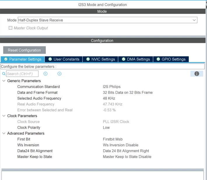

Hello @nouirakh ,
I have absolutely same issue with STM32H723ZG. I use same I2S and DMA configurations. I've verified that the HAL_I2S_RxCpltCallback and HAL_I2S_RxHalfCpltCallback functions are being called. And all input samples are 0s. I tried I2S with both 16-bit and 24-bit data format and in both cases I've got same result.
Could you please help with further investigation?

Hi
This also seems to be an issue on the STM32H725. As i also have an I2S as master receive, and another as slave receive. I get all the interrupt, half/full complete on DMA on both the master and slave receive. The master gets correct data, but only 0's on the slave.
I have also measured with a scope that there exist data on the slave receive pin.
@nouirakh I would also like to know if this is an issue on the H72X micro, as it does not say anything in the errata?
Hope to hear more from you.
