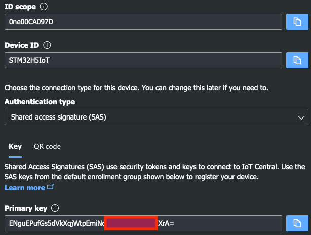

I have successfully got data going to Azure IoT hub, but now need to connect it to Azure IoT Central instead.
I've not managed to get it to connect successfully though...
This is the device settings, which are in the azure_iot config.h file, but I've been messing with it for a couple of days and can't tell if the problem is with some IoTCentral setting, or something in the firmware config...
Anyone else had success with this board?  Most of the examples are for the other U5 board which I don't have.

I am able to connect a STM32H573I-DK to Azure IoT Central.
Azure IoT Central uses DPS.
In the application configuration file app_azure_iot_config.h, check that DPS is enabled, ID_SCOPE , REGISTRATION_ID, and DEVICE_SYMMETRIC_KEY are configured.

Rob Ashworth
Senior
July 18, 2024
Thanks Guillaume,
for the 2nd time you have fixed my problem!
DPS turned off was the problem, I just need to learn how to learn Azure IoT Central properly now.
