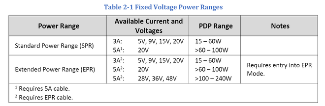

Best answer by HFISTM
Ok, I understand your question now. In fact, 12V is out of spec. See this extract from PD 3.1 spec:
That is why you cant select 12V from CubeMX. But anyway you can still put 12V in the usbpd_pdo_defs.h file "by hand" if you want, it will not be in line with the spec, but I will most likely work.
Regards

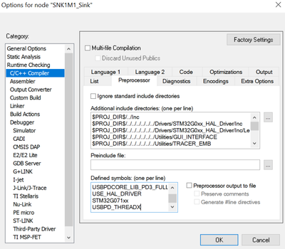

Hi @ABasi.2
Unfortunately, we don't provide direct example for your case!
Did you check USBPD_THREADX symbol to enable in ThreadX support for CubeMonitor API?
To give better visibility on the answered topics, please click on "Best answer" on the reply which solved your issue or answered your question.Best regards,FBL

November 6, 2024
Hi @ABasi.2
USBPD_THREADX can be added as predefined symbol to be used by Cube Monitor UCPD to integrate code that is specific to the ThreadX. Then, using _TRACE and _GUI_INTERFACE, traces in UCPD monitor can be accessed.

ABasi.2
ABasi.2Author
Senior
November 6, 2024
hello @Nicolas P.
i have 100 !
is this the problem?
i have searched the
USBPD_DPM_TimerCounter()
is defined in usbpd_dpm_core.h but is never called in the code!
where have to be called?
 it is supposed to be called frome "cubemx code" or by the user?
also can you clarify to me where is the  USBPD_THREADX symbol enabled? i didn't recognize the page posted by FBL
thank you!

ABasi.2
ABasi.2Author
Senior
November 11, 2024
hello @Nicolas P.
if i put a break point on the HAL_IncTick();  or USBPD_DPM_TimerCounter(); its breaking continously so i assume the tick is going.
i i break the code is always breaking in the _tx_thread_system_return(); in the file tx_thread_system_suspend
there is no trace on the cube monitor ucpd.
i don't have another thread created by me,
i have slavishly  followed the ST tutorial on youtube:
https://www.youtube.com/watch?v=cbdFHmMOMwk&t
but i have selected azure threadX for operating system
and also:
1) make the tick  per second 1000
2) make the timebase source TIM6
3) added
if (htim->Instance == TIM6) {
	 #if defined(_GUI_INTERFACE)
	 GUI_TimerCounter();
	 #endif
to the HAL_TIM_PeriodElapsedCallback(TIM_HandleTypeDef *htim)
maybe there is some modification to enable the UCPD thread? is not automatic started?
