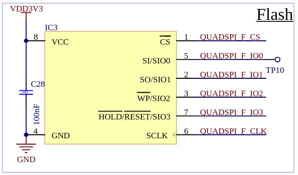

I'm using a STM32U5A5 MCU to communicate with a FLASH device through OCTOSPI.
Flash is connected to port P1, and all signals are controlled by OCTOSPIM / OCTOSPI1 MCU hardware.

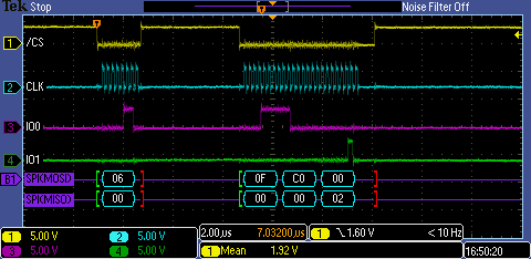

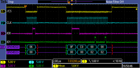

What I see is that function HAL_OSPI_AutoPolling() seems to be reading 1 extra byte :
The first 06 command is my WRITE_ENABLE command on 8 clocks.
The next 0F C0 command is isssued by polling. Note the 2 bytes "02 02" in output. Polling stops immediately because condition is met. Total is 32 clocks, while it should be 24 clocks only.
If I don't use HAL_OSPI_AutoPolling() but HAL_OSPI_Receive() to manually read once the STATUS register, I have the expected signals :
First command is "06" = WRITE_ENABLE on 8 clocks.
Next command is "0F C0" = GET_FEATURES(STATUS) and status value = "02" as output. Total is 24 clocks as expected.

KDJEM.1
Hello @Fabrice_GIRARDOT,
The OCTOSPI interface may generate up to six extra dummy clock cycles after it reads the last data due to internal synchronization.
So, it is expected from the OCTOSPI sometimes to send extra clock cycles when making read operations. The OCTOSPI filters the received bytes and takes only the considered ones.
So, sending an extra clock cycle when reading the status register gives you always the status register with an updated state. It is not impacted the application or the memory. This behavior it is not impacting the OCTOSPI/Memory functionality.
This phenomenon is documented in RM0456
Is my reply answer your request?
Thank you.
Kaouthar

Hello @KDJEM.1
Your reply fully answers my request.
Thanks a lot !
