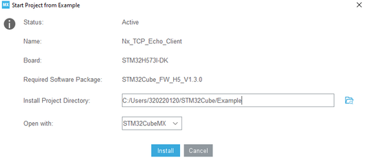

The Project was setup like this:
My only modification:
#define TCP_SERVER_ADDRESS IP_ADDRESS(192, 168, 0, 213)
#define MAX_PACKET_COUNT 10000

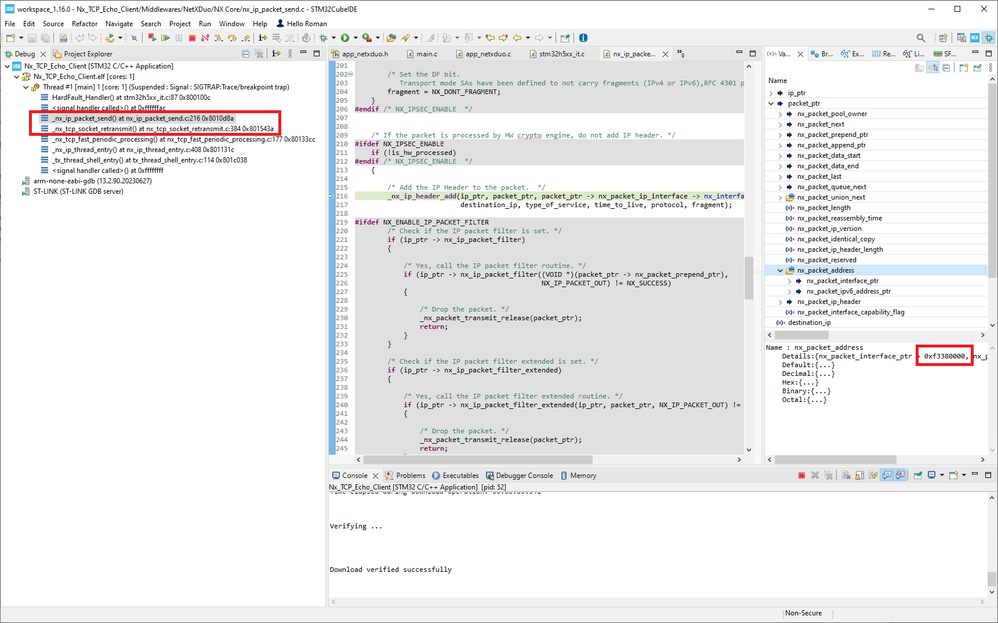

Here a screenshot:
It seems that a pointer gets damaged as the address 0xF338000 makes no sense.

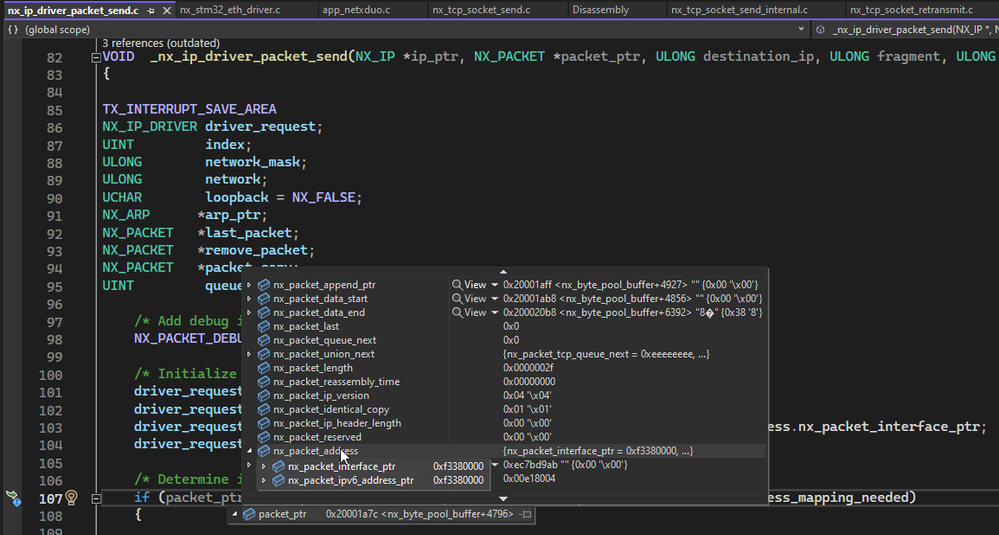

I have take a closer look to the problem. I thing something is wrong with the re-transmit handling.
Here is the problem:
1)  A packet of type NX_PACKET is send using nx_tcp_socket_send()
2)  After a few calls the function _nx_driver_packet_send() is called. Inside that function the packet structure is overwritten to build the massage header. See here:
2024_09_24_10_51_23_TCPClient_Debugging_Microsoft_Visual_Studio.png4) After a timeout, the pointer to the now damaged NX_PACKET structure is used for a re-transmit in the function _nx_tcp_socket_retransmit()
5) In the function _nx_ip_driver_packet_send() the pointer access will fail. See here:
Seems to be major issue in the re-transmit process of NetX. I'm surprised that no one has ever noticed that. Doesn't anyone ever pull the plug during data transmission? Happy path programming is only a small part of the job.
