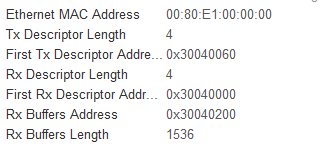

2024-09-05 2:09 AM - edited 2024-09-05 2:45 AM
Hi @STea ,
I work with H750. And using external flash with bootloader.
And as attachment, is my setting for MQTT applicatoin.
